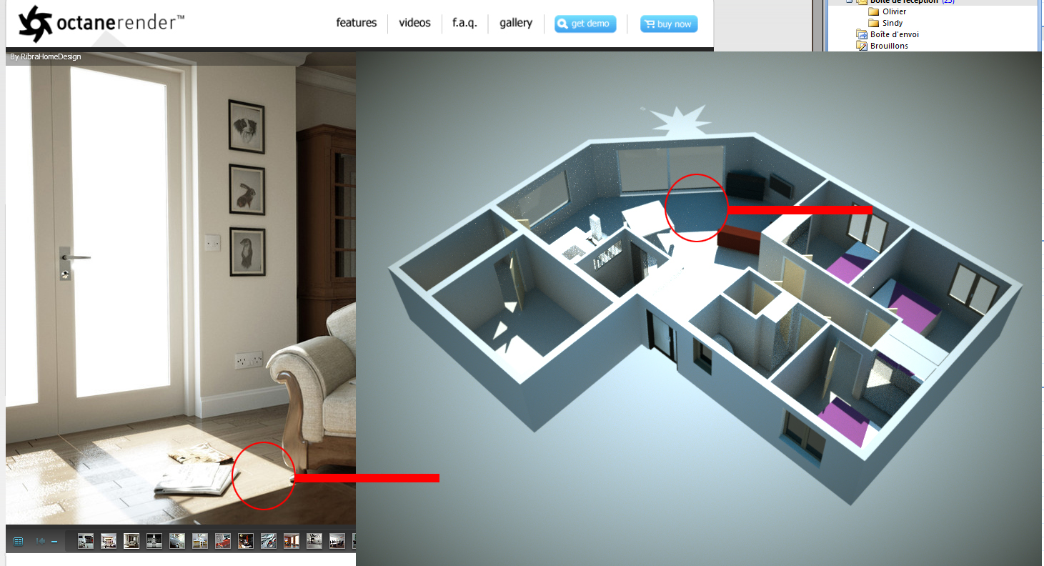

in this picture, we can see on the right the windows let the ray light going throught the glass.. not in my picture...
question : is there real polygone with glasse material in the right picture or is the windows empty ?
i can't find the solution in my project.

where are the ray light ?
Un probleme evoque a de tres nombreuses reprises sur le forum...
Pour l'instant le sun & sky ne sait pas traverser les surfaces transparentes.
Pour obtenir cet effet, il te faut une HDRI ou calculer en 2 fois (avec et sans vitres) puis compositer.
La question est de savoir si tu as vraiment besoin des vitres (effet de reflexion)
google trad
A problem has evoked numerous occasions on the forum ...
For now the sun & sky is not able to go through the transparent surfaces.
For this purpose, you need an HDRI or calculate 2 times (with and without windows) and then compositing.
The question is whether you really need windows (reflexion effect)
