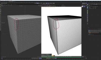

Here's an example of what I mean, in the form of a cube. My cube has a bevel, and when I apply the Octane tag and increase my subdivisions it causes denser regions of polygons within the bevelled area:
When I apply a noise displacement to my object, if I'm in object projection mode on the noise, the noise is rather concentrated along those edges which is not ideal.

Usually XYZ to UVW projection works best for procedural noises, unless you're animating a deformation on the polygons.
