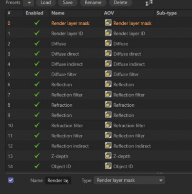

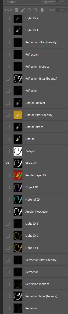

Did a file with Multipass but in psd got 110 layers....!
How can I get which I applied only...?

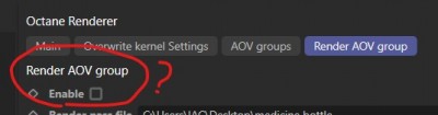

Do you have render layer activated? What happens without it?
iacdxb
Posts: 36
Joined: Tue Jan 12, 2016 6:07 pm
You mean Render AOV Group...?
Without enable, it does not saves and no psd layer file.
