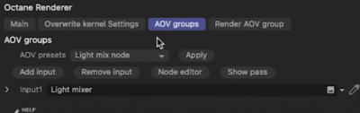

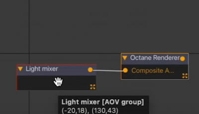

Ok, is there a ipr lightmixer in Houdini too, like Octane for Cinema 4d has?
juanjgon
Posts: 8867
Location: Spain
Are you talking about this node? I suppose that you could use it inside the RenderTarget like in Cinema, or in Standalone.
