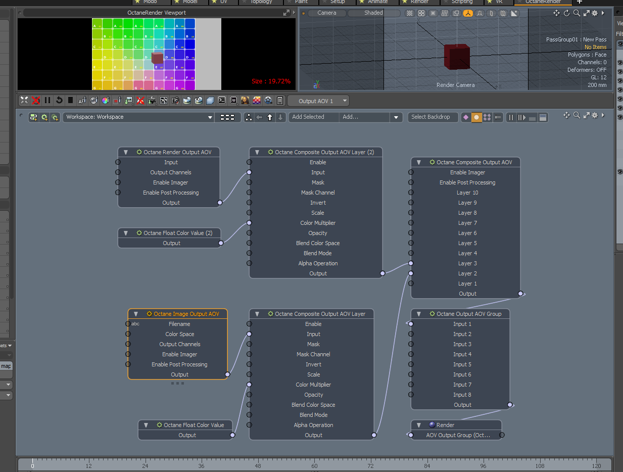

Hi. If you want to use the environment as a backplate image, then you will need to use a spherical HDRI map. Alternatively, you can drag the Kernel->AOV Output Group property onto a workspace, and setup the compositor as follows. You need to turn on Kernel->Alpha Channel.jwfvr wrote:I tried that, but it seems like the shadow catcher only works with images in the environment - so a shadow catching plane is visible when in front of the backplate image. is there a way to change the projection type of an image in the environment? or is a different approach needed?

But after that it will be not visible in reflections right ?face_off wrote:Alternatively, you can drag the Kernel->AOV Output Group property onto a workspace, and setup the compositor as follows. Paul

Correct.But after that it will be not visible in reflections right ?

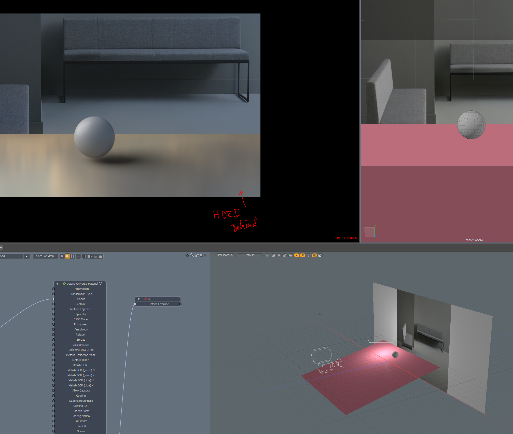

If you follow Paul's last link, there is an example using the new "sample pos to uv projection" with an environment texture.
This will work with a shadow catcher since it's using a visible environment, and still allows you to select which rays affect the render.
