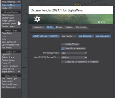

In the plugin options panel, where you can configure the GPUs and so on.
-Juanjo
