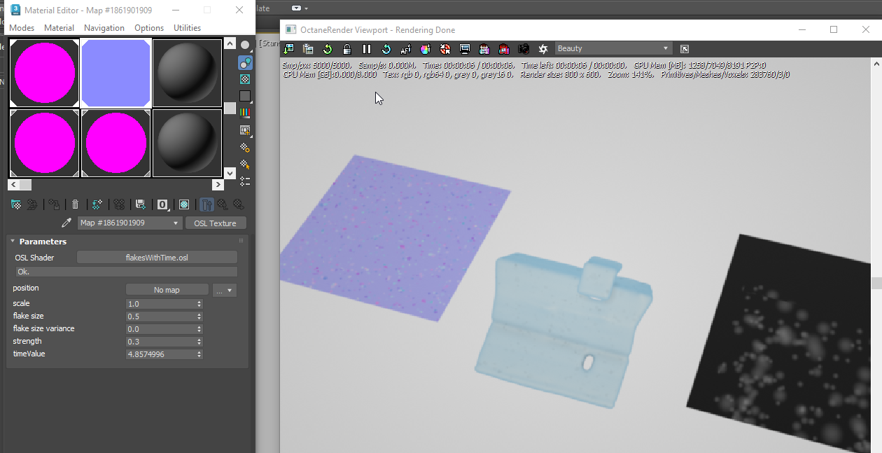

Hi coilbook,
You didn't include the flakes.osl file, but I guess that the same that I got.
You loose the colors if you use it only in the Normal slot..
I you use it in the Diffuse slot, there's the blue-ish color .. you could change the (0,0,1) at the bottom of the script for other base color..
The snow effect makes more blurry particles, and they move with time.. as shown on the right plane.
I updated the flakes.osl to add some flickering with time: flakesWithTime.osl
Here is your updated sample scene, with the old and new osl: I hope that helps.

Thank you. Your flake shader actually works great. Would be nice to add sparkle when some snowflakes just spark really bright here and there. Currently spark depends too much on the reflected light. Would be nice to exaggerate this effect.
