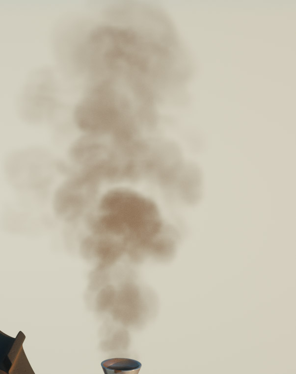

Hi coilbook,coilbook wrote:Hi,
Where is old volume behavior checkbox? Smoke now looks too flat. Thanks
This has been moved to the new 'Compatibility modes' system.
See the bottom of this post:
viewtopic.php?f=24&t=80814
For 'old volume behavior', set for example '2021.1 compatibility mode (with 4.0 volumes)' in Kernel / Direct light / Compatibility mode.
You can read details for each mode in the tooltip of this combo box.
Also, in Octane Preference, you can use the menu 'Info' to list all the modes available in all nodes.
Thanks. Why does smoke look worse with a new mode? It looks flat.neonZorglub wrote:Hi coilbook,coilbook wrote:Hi,

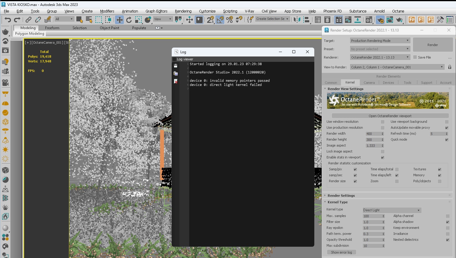

merid888
Good morning, when I try to send the render, appear this message, I need restar my pc and run again open OctaneRender viewport and works fine, any bug of the version ?
I mean in the version 13.15 is whorse the error, many times is repetive this message even when I restar my pc and I finish doing a new scene and works fine
And this version 13.13 is less this message but is a problem I want to believe
Thank you you can help me OctaneRender team.
