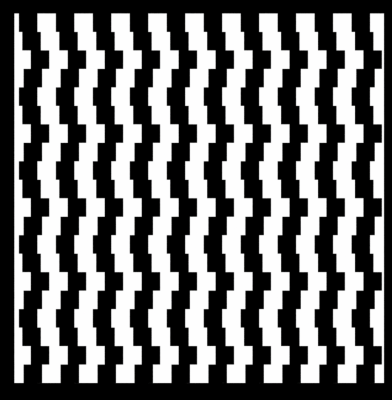

Here's my issue - I'm trying to create a horizontal 4 step gradient, with 0.25 / 0.5 / 0.75 / 1 float values. Managed to do it, but when I solo the gradient node, and pick its values from the LV (using the colorpicker), i'm getting 0.254902 instaed of 0.25, 0.494118 instead of 0.5 and 0.741176 instead of 0.75. Is there a reason for that? The node is solo'd so there's no light affecting it
Here's why I'm asking and what I'm trying to get-
I want to use the float values from the gradient to move another texture (vertical black and white stripes) on its X axis, with each step of the gradient moving according to its float value. I'm using the Distorted Mesh UV project node to do that, plugging the gradient to the Translation channel. The vertical b/w stripes should then form a zigzag pattern.
The gradient looks ok (4 strips of grey values getting brighter)
The final texture seems to *almost* form a zigzag. But it just doesn't align right. The movement doesn't seem to move linearly but more exponentially, and if I try to play with the Translation values in the pjorect node the texture jumps forward before aligning right. I can't figure out what's the reason.
Is the gradient the problem? Is the Distorted Mesh UVs not the right way to do it?
Here's how it turns out (tried to manually move it around for hours and it jumps around and never aligns) - also, attached the project file
Why doesn't 0.5 float equal 50% grey?

Hey Ahmet, thanks for taking the time to reply
Maybe I'm missing something but I have no color management and as far as I can tell every setting across the board is set to linear.
But, beyond that, what do you think about what I'm trying to achieve? Why doesn't the distort mesh uvs work in the way I'm attempting to? I feel like we can really open up Octane to a whole world of users who are more procedural-focused, and can benefit from shedding light on these mysterious procedural workflows in C4D+Octane.
