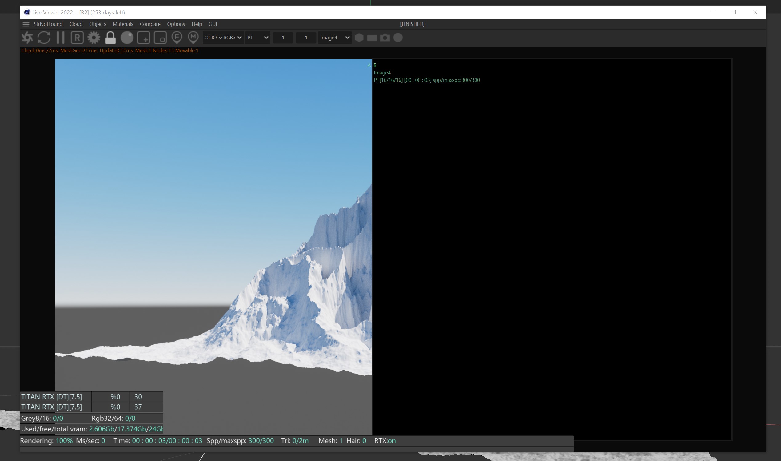

I can confirm the store render buffer comparison is not working correctly. In older scenes, it doesn't do anything or just shows black.
To make it work, I have to create a new scene and copy/paste all objects into it. Then it works.
store render buffer fail (2).zip
(21.15 MiB) Downloaded 139 times
Asus Prime Deluxe II : Intel i9-10900 X : 128GB G.Skill 3600 MHz DDR4 RAM : (2) Nvidia RTX TITANs w/ NvLink : Win11 Pro : Latest Cinema4D
Posts: 16068
Location: Türkiye
dynaraton wrote:I can confirm the store render buffer comparison is not working correctly. In older scenes, it doesn't do anything or just shows black.
Nope, just switch to any HDR buffer type then it will work. Problem is that cryptoMatteFalseColors=FALSE case is not working with LDR buffers and it's FALSE by default in tonemapping functions.
OK thank you, tested and working now

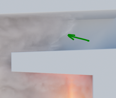

there is this line: it comes from "denoise volume" But why?
