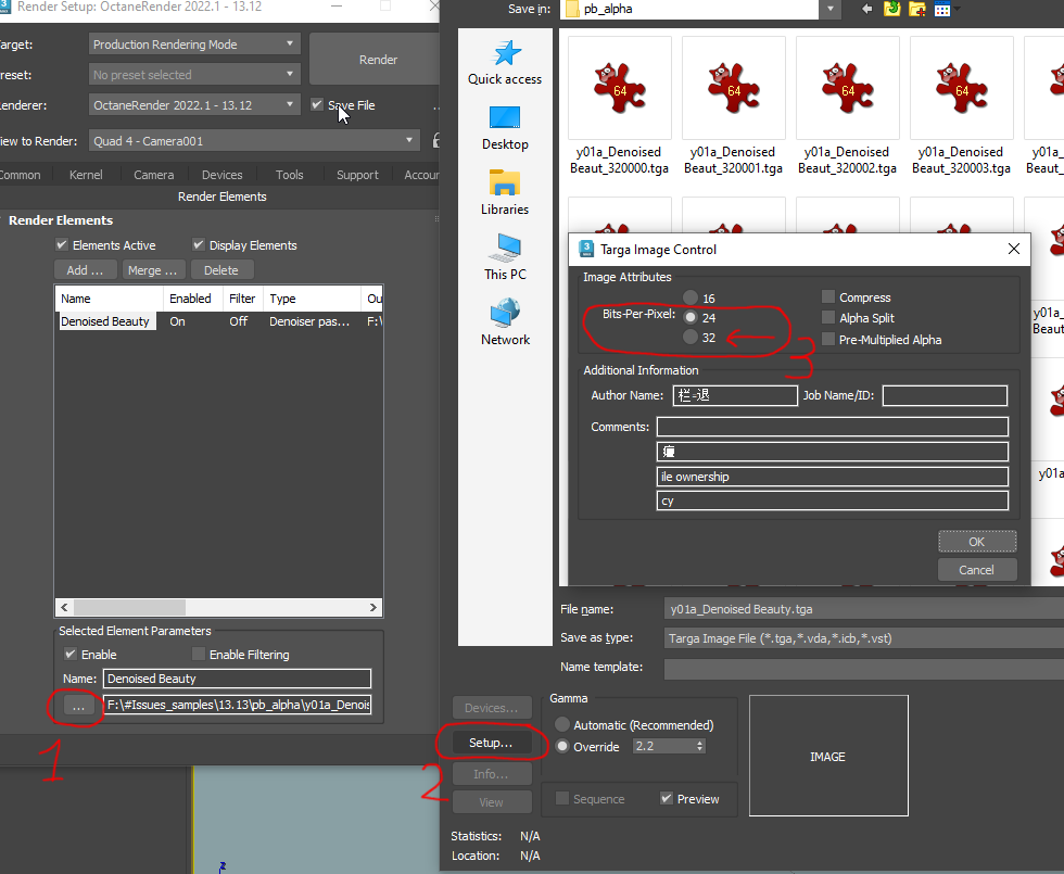

Here is the problem I have with alpha.
In octane viewport I have the alpha, in render I have the alpha channel, and in denoised render I have no alpha.
I I use render alpha for denoised render, a fringe appear at the alpha limit.
If I check "use denoised beauty instead of beauty" I have two denoised renders one with alpha and the other without alpha, but I have lost my undenoised render...
grrrr !!
I join my file if it can help
pb alpha.zip
(38.53 KiB) Downloaded 128 times

Hi HHbomb,
Thanks for the sample scene ! I could reproduce the issue.
There seems to be a bug in the way the render elements are saved in the scene.
A simple solution is to Delete the 'Denoised Beauty' render element, and to re-Add it.
I also noted that when saving as png from your scene, (with alpha enabled), It saves a corrupted black and white image ..
This is also fixed by deleting and re-adding the render element..
I'll keep investigating to fix this issue.
Thanks!
And thanks for reporting the ray epsilon in Preferences.. this will be fixed in the next release.
[EDIT]:
The reason of no alpha was the tga settings. In your Render element, is was set to 24 bits per pixel.
You just need to change it to 32.
Unfortunately, the Octane plugin can't check those settings, all the supported formats and settings are managed by 3dsMax.
As for my test with a corrupted png, it was somehow set to Monochrome 1 bit / pixel..
So those settings should be the first thing to check if an output seems wrong..
