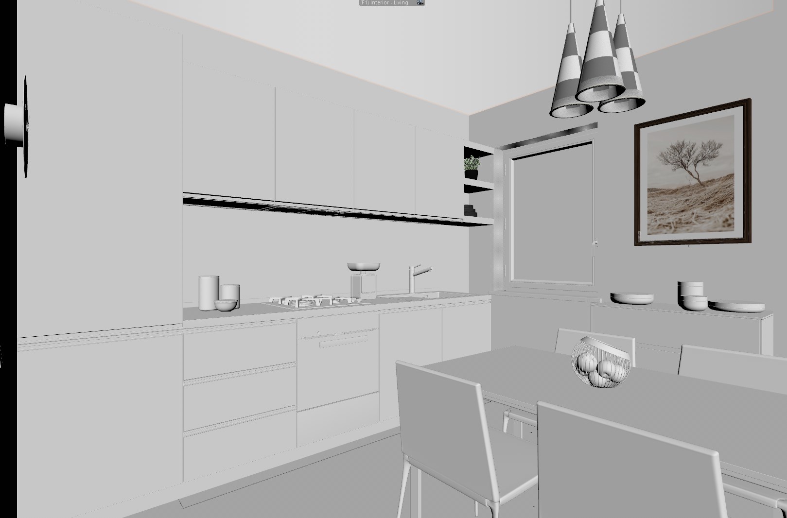

here I am.
This is what I see in viewport while LV is rendering and Octane already loaded all the materials.
I hope you can help me. I double checked all the parameters and are like yours.
Thanks again!

shine71 wrote: here I am.
Thanks again!
Did you try with another old scenes? Also what happens if you add some new materials and assign to some objects? And is "Octane for OPENGL" checked?

Hey Ahmet!
I tried with few of them and it's always same behavior.
Octane for OpneGL is checked.
I try with adding materials and run some other tries.
I'll let you know :)
Thanks!

shine71 wrote:Hey Ahmet!
Thanks!
What's the situation there?
