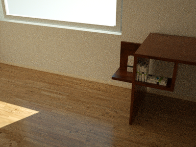

Hello, i did small interior scene. I want to know can i light scene a bit more, with day light from Octane. I got only one window - quite wide. How can i do it, if i adjust ISO etc. it just burns out main lit area. Is it even possible? I guess that when i am aiming for is a bit unrealistic. In 2nd test i got rid off ceiling, that is surly not realistic ;], but i got the lighting i needed with HDRI map applied + high exposure. HDRI map wos burning like hell but scene wos lit as i wanted. Another quistion is are fireflys the side effect that will never be reapired? I know we got the "remover" but it is not always best solution. I haven't seen on this forum any kind on interior render with small window, everyone uses almost a wall of windows in their work is that because you had same problems like me or that is some modern design thing
? I had similar problem in other programs but they had solution for that. I could just darken the burned area, or lit the dark one. Here i can't its just one slider that both ways makes me angry ;]. Another thing, if i will render much longer like 2 hours will i get less noise, becouse i got 2 render 12 min and 31 min they were same.
with HDRI
