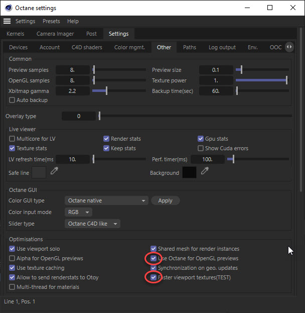

Hi everyone.
Sorry for the silly question, but why opening a scene made with 2021 I don't see any texture in viewport but all the amterials look white?
Thanks and have a great day

shine71 wrote:Hi everyone.
Octane materials? Compare your settings with mine
Maybe you didn't notified but no lags anymore while editing materials. It's because new system which comes with "Faster viewport textures" option. There should be some factor which is related these.

Thanks for your reply, I didn't make so many tries so far to assess this progress, just installed.
Glad to hear about no lags, though I noticed that till I render first time in LV all the matrials (octane materials) look white.
maybe it's correct int his way, I don't know.

Try a bit and show me your screen shots. I'm not sure without seeing something.
