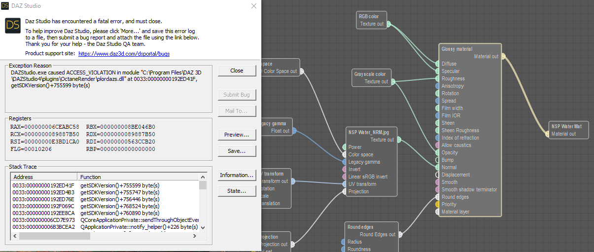

I did a collapse inputs on this glossy material and it crashes (did it twice to check).
DAZStudio_error_report_221126-120422.zip
(144.17 KiB) Downloaded 105 times

SiliconAya wrote:I did a collapse inputs on this glossy material and it crashes (did it twice to check).
Thank you for reporting, I'll look into it.

The above crash has been fixed in viewtopic.php?f=44&t=80847
