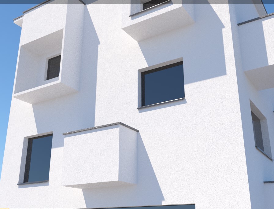

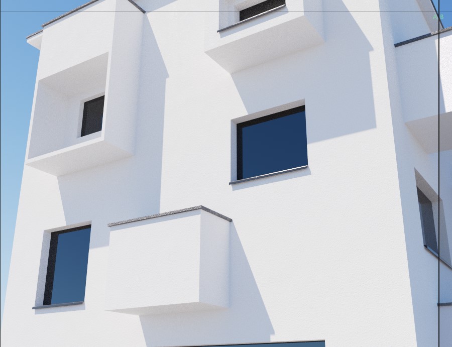

Every of us know that ACES can be bad in the terms of color shifting. Mainly blue color that is shifted to cyan. This color shifting is mainly visible using Hosek&Wilkie sky on the reflections like window glass. Strange is that it is not visible on Sky itself.
I think that H&W Sky model needs to have switch to compensate this color shifting. Probably this sky model shouldn't be used with ACES. For example, ACES P30-D60 looks great without blue color shifting but it has less saturation and contrast.
Probably there is something wrong with Hosek&Wilkie blue sky color that is not suitable to regular ACES. It should be little moved to the more temperature in Kelvin scale so it will be more blue not cyan like.
sRGB :
ACES :
blue_shift_aces_srgb.zip
(353.99 KiB) Downloaded 108 times

Right, but this cyan cast on dark blue reflected areas is from Hosek&Wilkie sky model. Other colors looks fine as should be.

This color cast can be reduced or changed using Hosek&Wilkie ground color. It works better than changing whole image colors by Camera White Point.
Also I compared H&W clear sky to one of the best clear sky HDRI maps and I think that HDRI has better colors than H&W using ACES by default.
