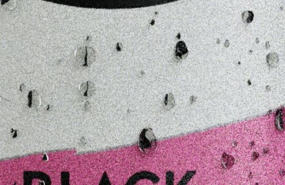

HI everyone,
I've got a bit of a problem that I can't seem to figure out. I'm trying to make water droplets that are just see-through, but they're picking up very heavy black reflections. Is there a way to mitigate or eliminate this problem? I've attached a screenshot of what I mean
Thanks so much!
Liquids have nasty black reflections.
- jayroth2020
- Posts: 488
- Joined: Mon May 04, 2020 7:30 pm
Try increasing the Specular depth in your Kernel Settings...
Puget Systems / Intel Core Z790 ATX / RTX 4090 / Cinema 4D
Primary recommendation from jayroth ^
Secondary would be to double-check that no mesh is intersecting.
It is also recommended to verify that all other settings are properly set as well.
