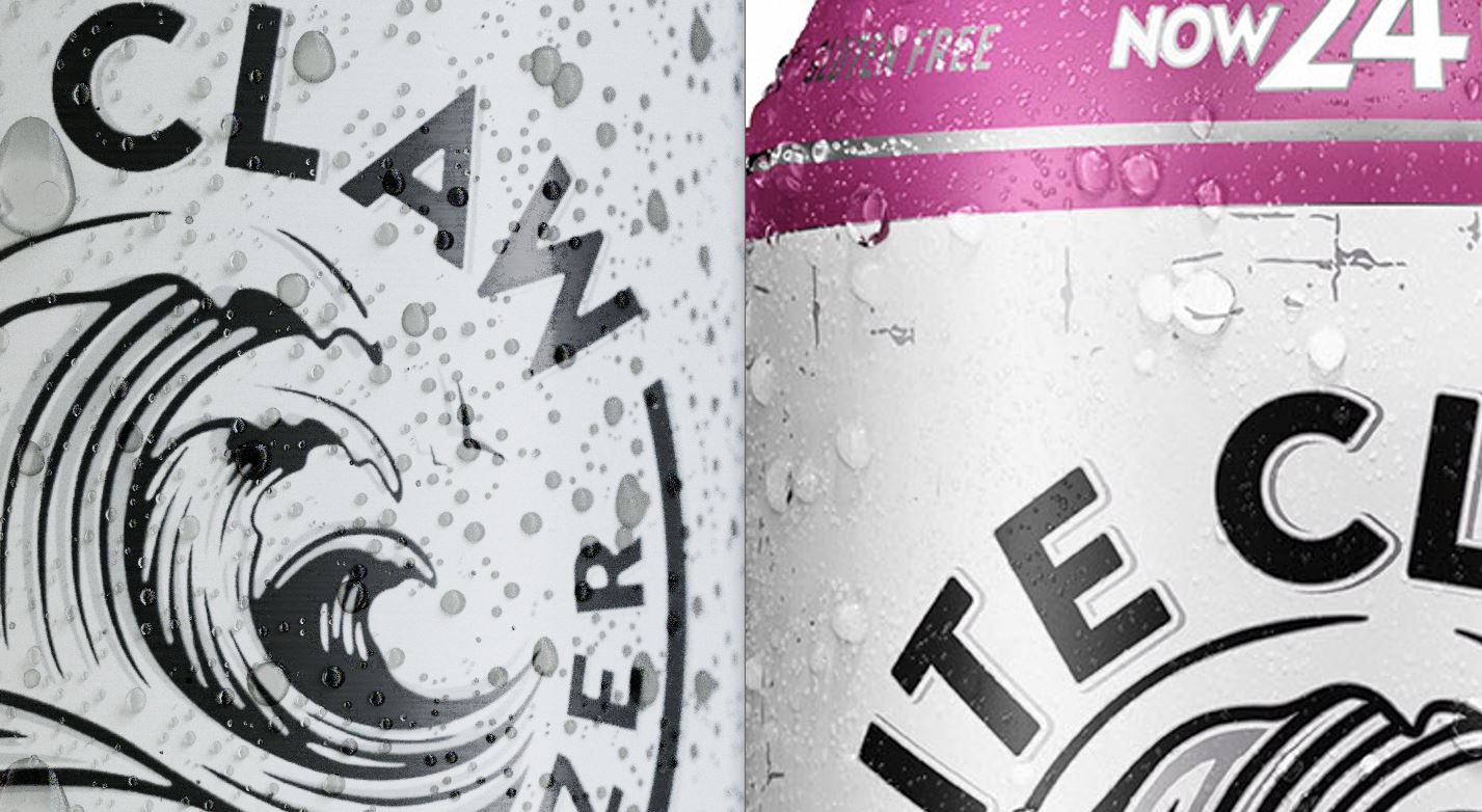

Thanks guys, that got me much further to where I need to be - I'm currently here:
The left is my preview window, and the right is the photograph my commission is based on - I'm trying to get that completely see-through look to the water, but I'm still struggling. Definitely much closer, and now wondering if there's any hacks. I can do
Thanks dude. The lighting isn't an HDRI, it's lit by ten area lights. I'd already followed all the instruction on that page, it's a great resource.
This time round I managed to solve by switching to PMC. The bubbles instantly went see-through, exactly like the other image.
Thanks for the help, I wouldn't even have thought to switch to PMC if I hadn't been sent down a path by your responses, much appreciated
