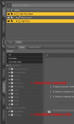

The material you're looking at is not for the hair, it's for a separate object the vendor included with the hair to help hold the ponytail strands together during the simulation. The opacity is set to 0 - which is why you don't see it in the DAZ viewport, if you changed it to 1 you would see the same white object you're seeing in the Octane viewport.
This screenshot may help clarify (click to view it full-size):

Thanks for that info. @huakiami has nailed it - that material should be transparent, i.e. set Opacity to 0.
