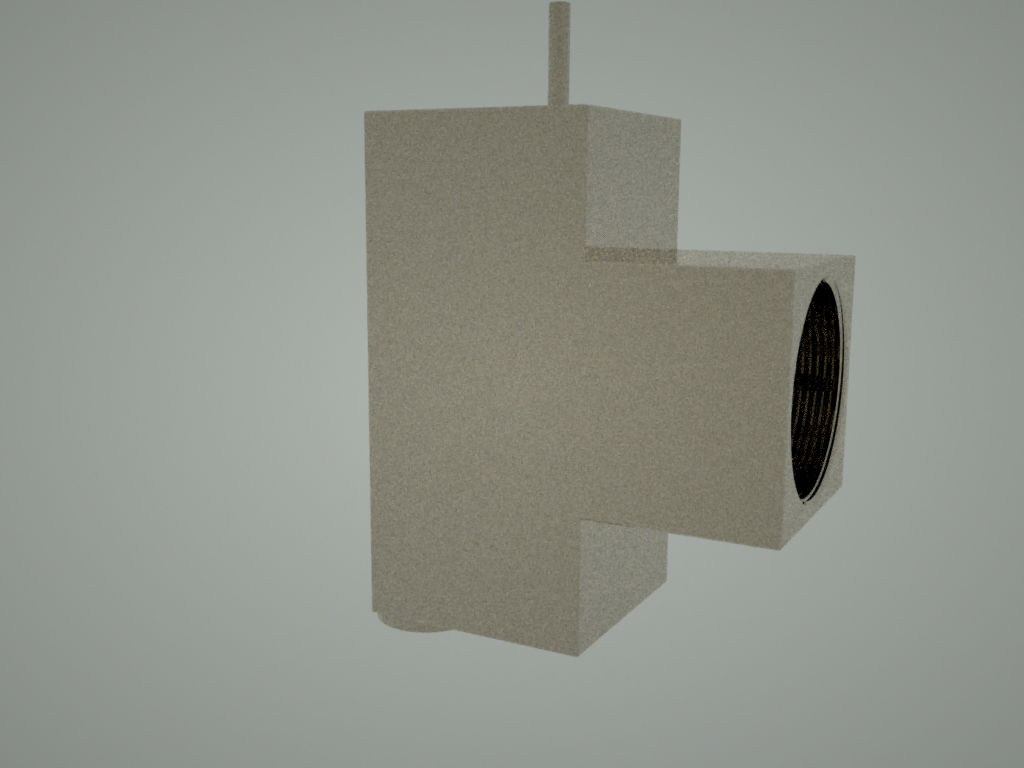

Here is a part that has to be included into the animation (I forgot to mention that I have to render an animation, I don't know wether this could give someone an idea).
You can see that this part has a very big surface that acts as a mirror. Everything added into the scene to be reflected here will disturb everything...
I can't obtain a more greysh color... any idea ?
Thanks.

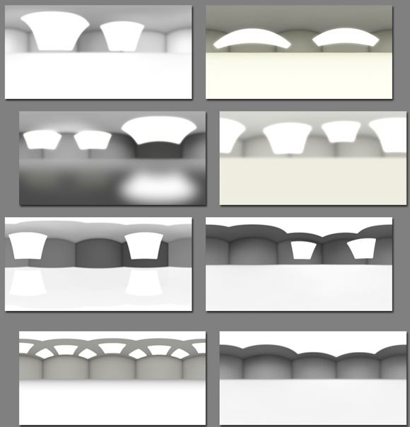

http://download.mcneel.com/s3/mcneel/br ... io_HDR.zip
try these HDRIs (these are free)..they are pretty OK for what you want to achieve..rotate hdri until you have a white backdrop...
(not sure if this will be appropriate for animation..depends on your camera path..)
