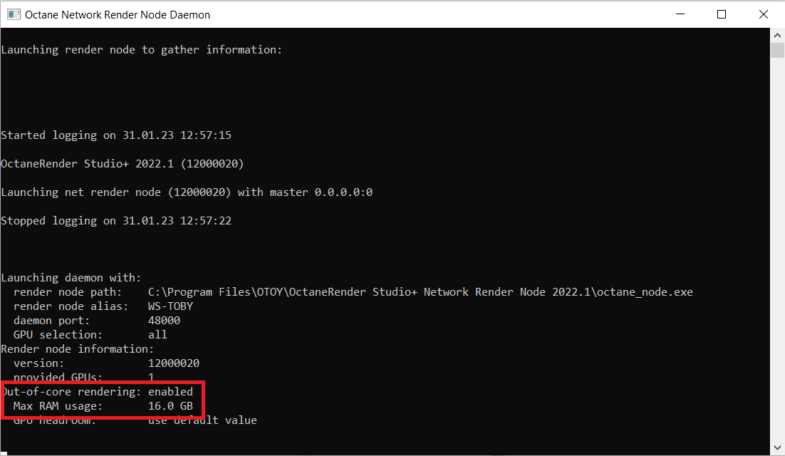

Hi. I'm not very familiar with the network rendering feature, but I don't think it's likely that this issue is specific to the Daz plugin. Have you tried exporting the scene to an orbx file and rendering from OctaneRender Standalone? Check that the render node is configured to use OOC - this is a separate configuration to the setting in Daz Studio on the primary machine. I just tried it now and when I run _install_daemon.bat to set up the render node it asks some questions, including whether to use OOC and how much RAM to use. When I run the daemon, it shows a window like this:
So, please check that your daemon is configured with OOC enabled.
