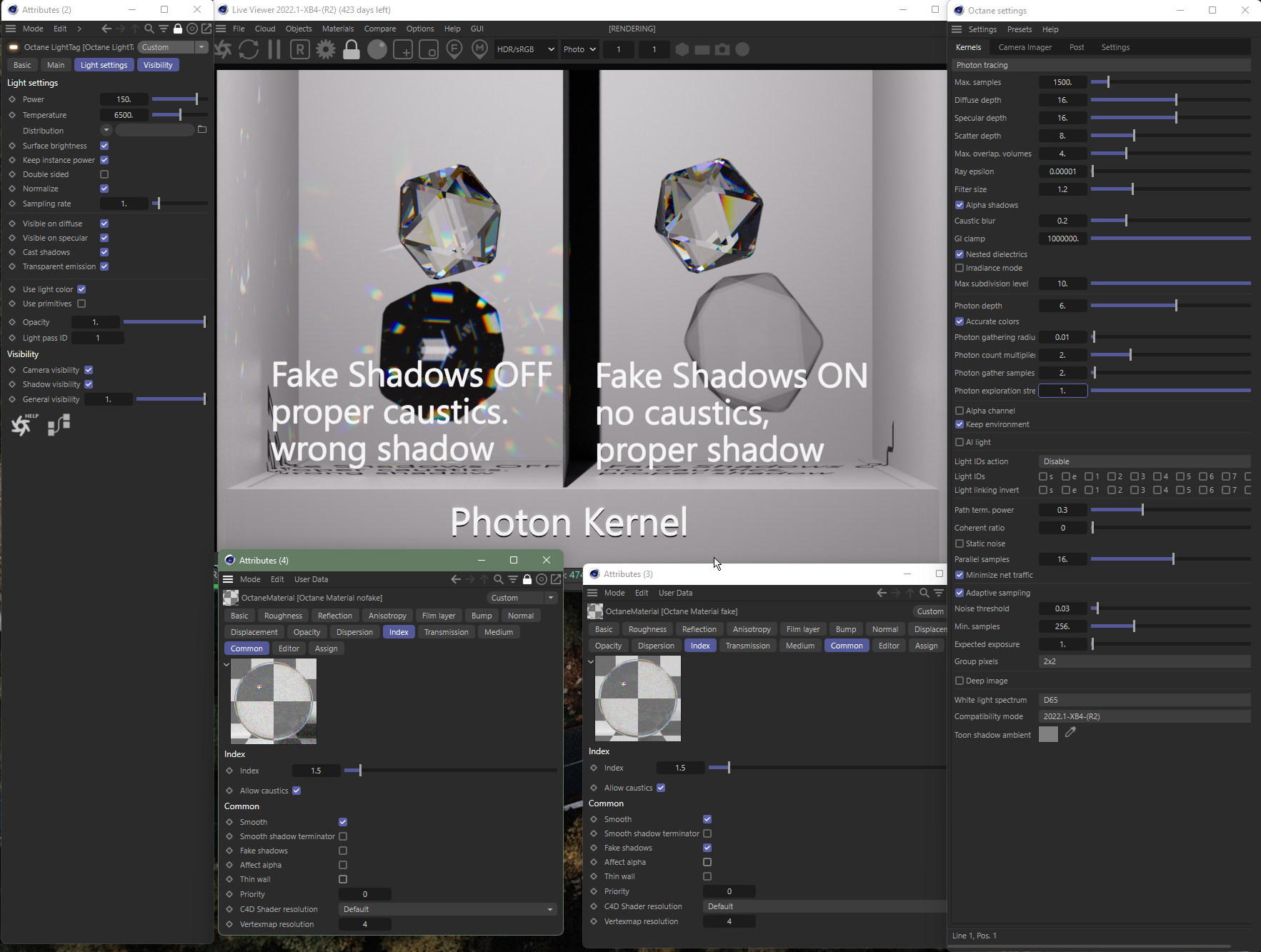

I found out, that when i tick fake shadows to get proper shadows for specular object, caustics don't show.
I did a screenshot (attached) to show my settings and render result.
Is that known problem or I just missing something?

screenshot with settings and render result

Yeah, the platonic object was just so thick, that it looked as a solid object from shadow perspective. I've tested with thinner object and it works OK.
Thanks!
