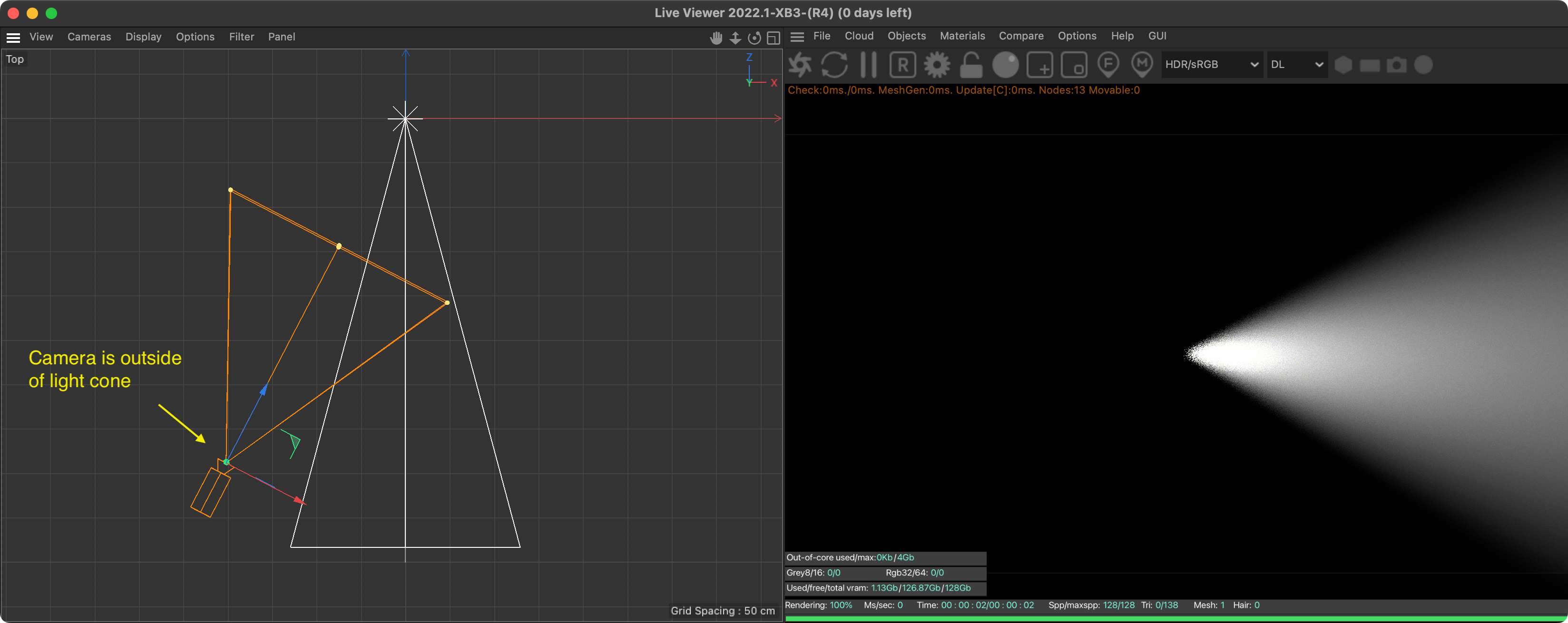

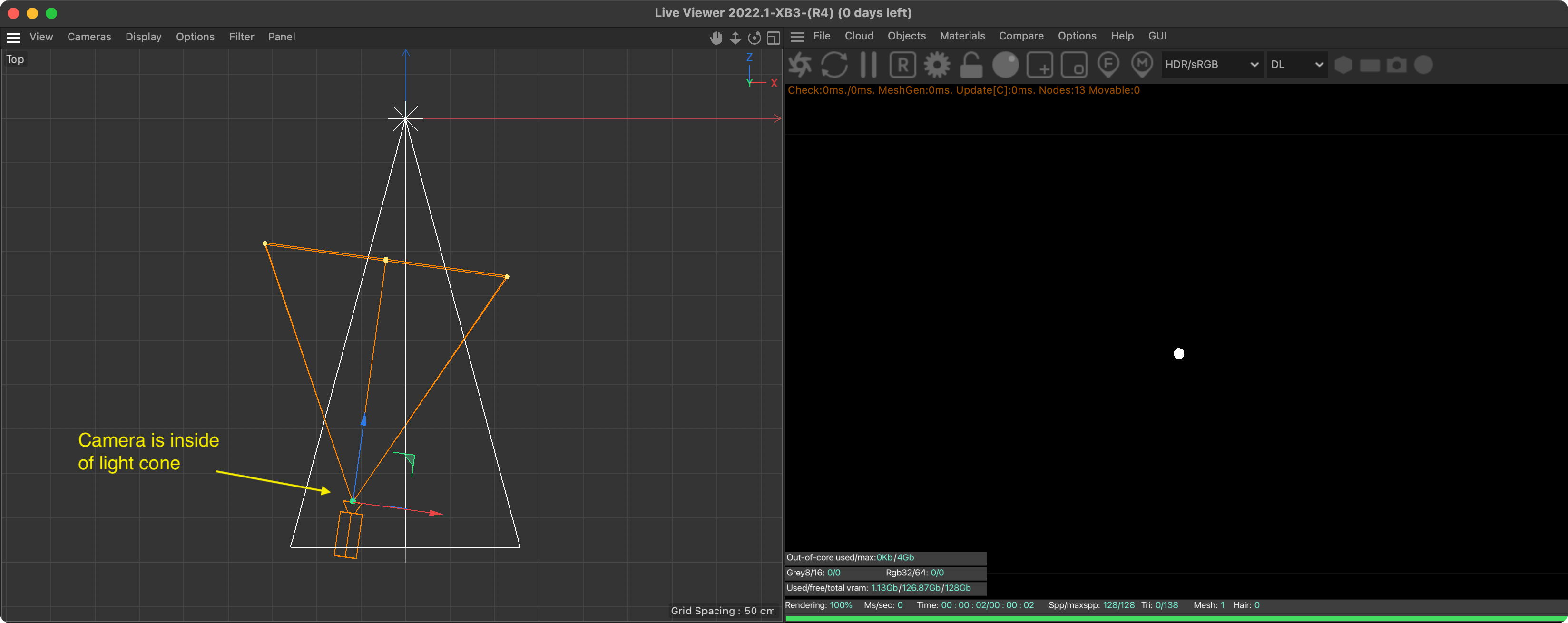

This may be something you already know about this build... but Volumetric Spotlights do not render correctly if the camera passes inside the Light's cone. The volumetrics disappear completely while inside the cone... reappear when you exit. Renders correctly on PC.
