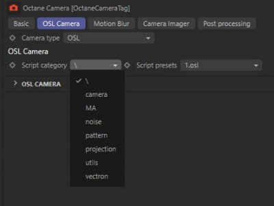

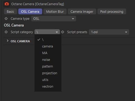

khomatech
Posts: 28
Joined: Wed Jul 20, 2016 3:27 pm
moebius wrote:
aoktar wrote: OSL camera should help
"OSL" and the what? for me, all scripts render just black :-/
Make sure you select 'camera' from the OSL script category dropdown.
