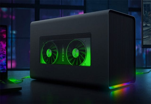

Tos
Posts: 13
Joined: Wed Sep 10, 2014 4:40 pm
Before you buy it, please check if it fits a 3090 (I'm assuming it is a 3-slot gpu), because I think it doesn't (the Razer Core).
