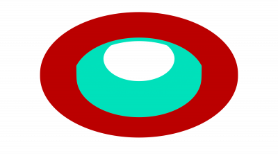

Hi All,
Is there a way to create a specific color on my 'Material ID' pass? As it is now, there seems to be an automatically assigned color to that channel. Im my case, I want the red to be white without having to mess with it in post.
paride4331
Posts: 4004
Hello,
The way would be to switch to Cryptomatte, alternatively a workaround (but it depends on the complexity of the scene) could be to use the object layer color, setting the colors you need.
Regards
Paride
