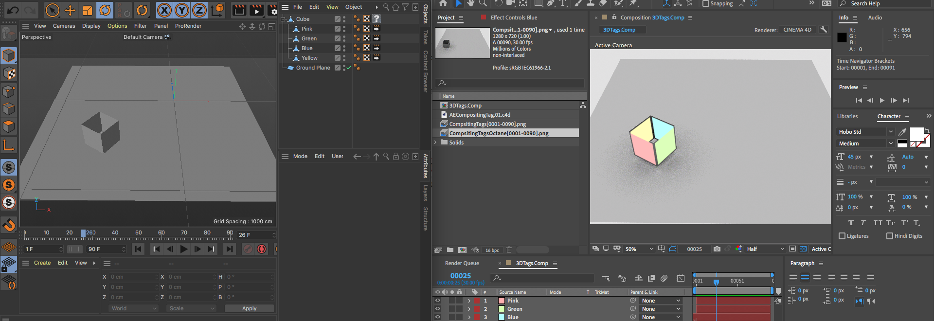

I'm sorry I lost sight of this thread last month. As far as I can tell, the External Compositing Tags are working fine with Octane and AE. I'm not getting any sliding or off-registration. I'll attach a simple demo scene in both AE and C4D based your description above. I've just tested it in
C4D R21.115
Octane 2019.1.5
AfterEffects CC 2019
Could you try uploading another sample file? The forum won't accept a raw .c4d file, though, you need to compress it first.
CompositingTags.zip
Simple C4D and AE Compositing Tag project files
(118.4 KiB) Downloaded 290 times
Compositing Tag, C4D and AE.
