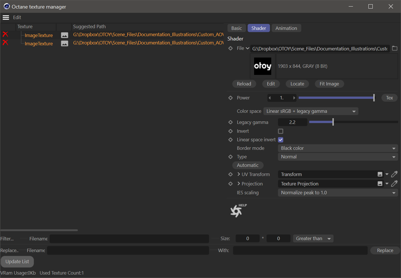

Right here, in Materials > Octane Texture Manager:
Just select the files and adjust them all at once. For compression, click on the Automatic button...

jayroth2020 wrote: Just select the files and adjust them all at once. For compression, click on the Automatic button...
This is not true.
1. You can select only textures with the same compression type
2. Even if you select textures with the same type you must click 50 times on "Automatic" type if you have selected 50 textures
3. You can do point 1 and 2 only if Cinema 4D will not crash because Manager is very slow and unstable when you have many textures.

Right for multi-selection. So we made a script to reset compression for all textures in all materials. Btw texture manager is not unstable, just making some calculation for accurate information.
See link
viewtopic.php?f=87&t=56039&p=415437#p415437
