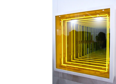

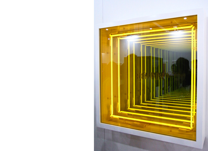

I am trying to create a two-way mirror for an interior project, a recreation of an artwork in CGI.
The mirror should have to be like the ones in Interrogation rooms.
To do that, I have to make the mirror object single sided. But octane identifies it as 2 sided.
Would you advice me somekind of a walkaround for that?
I think its not possible for a physically correct environment Or is it possible? or will it be possible to create somekind of effect in later releases?
