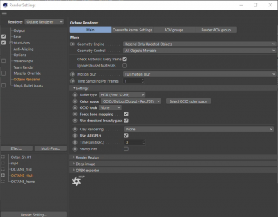

I can't seem to get aces to work on deadline with my computers. the computer that I submitted from with render but the other computers say the following.
2022-08-08 19:13:53: 0: STDOUT: Rendering frame 35 at <Mon Aug 8 19:13:52 2022>
2022-08-08 19:13:53: 0: STDOUT: Select some OCIO color space!!!
2022-08-08 19:13:53: 0: STDOUT: Render stopped because you need to select some OCIO color space to continue with the current OCIO option!!!
I have ACES all saved in the same location on each computer at C:\ACES\aces_1.2\config.ocio
I think it works set to ACES CG but not with Rec 709

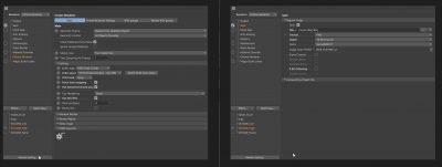

If I decide that I prefer the look I'm getting with Aces and tone mapping in the live viewer. And I want to have it in 16-bit PNGs SRGB, How should my render settings be?
I found I was able to get the look I wanted with the attachment setting below. It just wasn't working with Deadline.

gifmotion wrote:What do you mean it's not supposed to be changed?
ACEScg is not a "look", and the Rec.709 isn't either, both are "technical options".
In very short: ACEScg was designed as a working scene-linear colorspace (mainly towards "non-spectral renderers"). Rec.709 is one of the ACES ODTs (Output Device Transform). For any user-subjective look, it should be properly done in post or "implemented" as part of a custom OCIO configuration file (LMT, Look Modification Transform), for instance.
However, ACES is highly subject to avoidance. It doesn't improve the imagery as many people fallaciously think so. Moreover, Octane is even less requiring ACES as it is already a spectral renderer.
This is what Octane needs. The page is recent, and still a work-in-progress.
gifmotion wrote:If I decide that I prefer the look I'm getting with Aces and tone mapping in the live viewer.
Only ACES, other options named "tone-mapping" in Octane, are "disabled" or shouldn't be used.
ACES, via OCIO, is color-managing the whole project (and is the point of OCIO, although ACES fails at it).
There is something wrong in your screenshot. Refer to this page (which I did link in my previous reply). It's capital to aknowledge the fundamentals of Octane & Post Imaging Pipeline. If you can't find out after carefully reading the page, do not hesitate to reach out.
