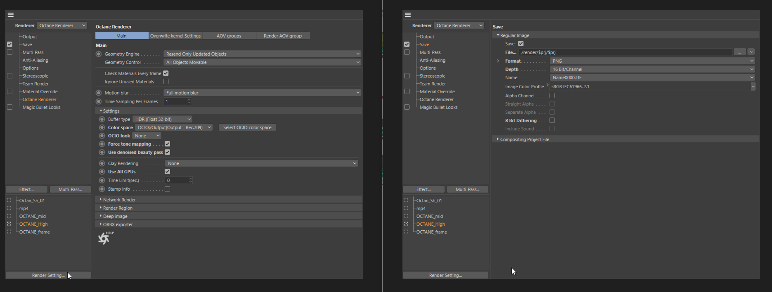

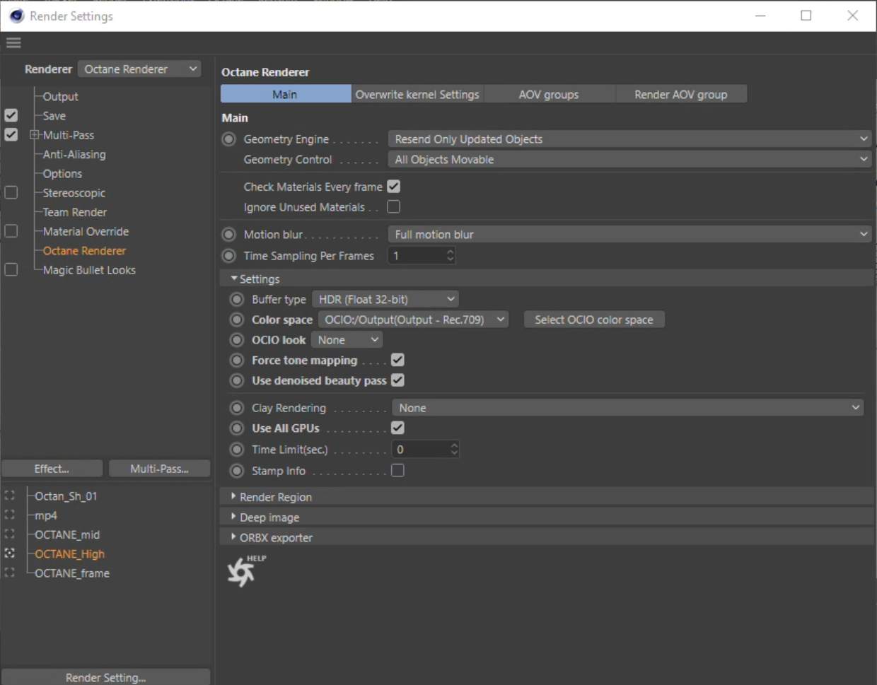

If I decide that I prefer the look I'm getting with Aces and tone mapping in the live viewer. And I want to have it in 16-bit PNGs SRGB, How should my render settings be?
I found I was able to get the look I wanted with the attachment setting below. It just wasn't working with Deadline.
