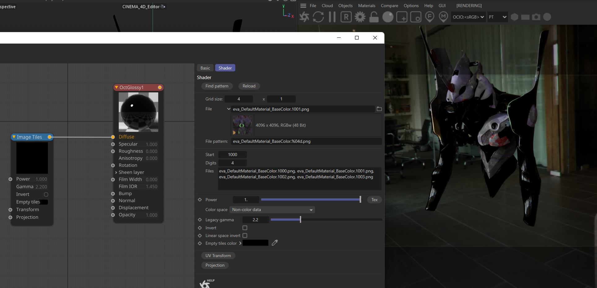

UDIM loading bug
UDIM loading bug
When you click find pattern it starts with 1000, grid size is defined correctly
This is the second time I've encountered this bug, the problem is not with the model
Posts: 16068
Location: Türkiye
Problem is that's start=1000 is incorrect. Set it 1001
Amaterasu
Posts: 41
Joined: Mon Feb 10, 2020 6:42 pm
aoktar wrote:Problem is that's start=1000 is incorrect. Set it 1001
Of course I tried 1001, but the problem is that it loads textures 1000, 1001, 1002, 1003, but my textures are all numbered 1001, 1002, 1003, 1004
If im set start to 1001, it will only load one Udim out of 4
It should be fine on 2022.1-XB3. Did you try in?
Amaterasu
Posts: 41
Yes, this exactly 2022.1-XB3.
