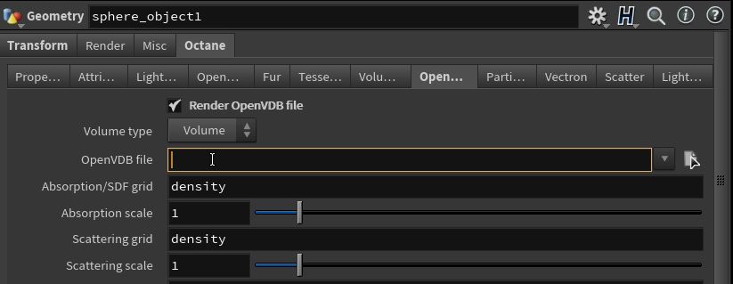

You should cache your volume objects as OpenVDB files that Octane can load at the render time if you configure them from the "OpenVDB" tab in the Octane OBJ spare parameters. The extraction of the volumes data directly from Houdini can be slow and it could need a lot of RAM for large volumes.

Thanks, i have combined a compress volume saved in VDB and i have load the file with your process and it's good ! much faster.
