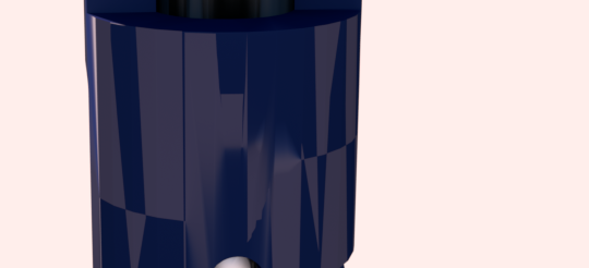

Hello, when rendering in octane I can see the polygons on the surface.
This 3D model was an original CAD file that I converted into an obj file.
If that matters.
I think I ran into this problem before.
But it's been a long time since I've been in octane.
So I have to refresh myself on all the troubleshooting.
Thanks for your help.

It looks like the normals are messed up. Render one of the Normals passes to check for sure.

elsksa wrote:Hi,
G.I.G.O applies here.
If a broken mesh is brought to Octane, there will be no micracle, Octane will output the broken mesh.
Ensure the mesh is properly triangulated, then double-check mesh-normals and Octane's smooth material option.
Thanks I unticked smooth and it made it better

face_off wrote:It looks like the normals are messed up. Render one of the Normals passes to check for sure.
Paul
Sorry I don't quite understand what does that mean. render one of the passes. I haven't used octane in a while

Settings Tab->Render AOV's->Normal (shading)->Open Viewport and you will so the polygon UV's in RGB format which I am guess will show that they are corrupt.

face_off wrote:Settings Tab->Render AOV's->Normal (shading)->Open Viewport and you will so the polygon UV's in RGB format which I am guess will show that they are corrupt.
Paul
Thanks, But it looks fine.

Can you send me the OBJ file please?

face_off wrote:Can you send me the OBJ file please?
Paul
It's okay now. I finished the project. I forgot to say the client gave me a 3D model engineered file that was in a STL format. I converted it to obj. Most likely that caused the problem. But I was able to work with it without issue.
