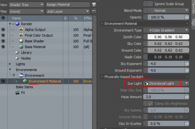

I don't know exactly how you are getting yourself in this state, but you may be loading modo presets that change the environment material, or deleting the directional light etc
The Octane plugin will always look at the environment material > "sun light" drop down, and use that light for the sun.
If it gets set to (none), just reselect the directional light again
