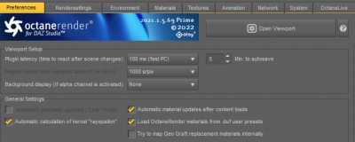

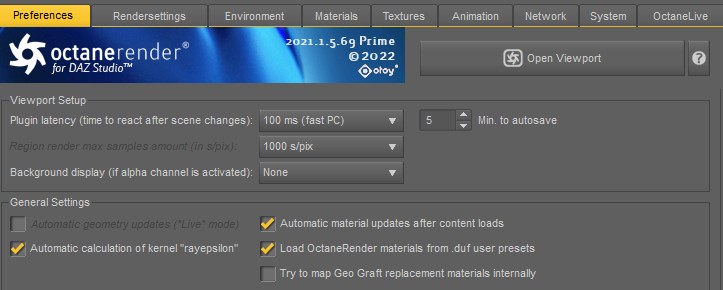

Can someone help me here please, why is "Live" mode greyed out and doesn't allow me to turn it on?

Hi RGUS.
That checkbox actually has no effect, so don't worry about it. I'm not sure why it's there.
Cheers,
Toby.

toby_a wrote:Hi RGUS.
Cheers,
Toby.
So there is no way to turn on "Live" as default at all then?

RGUS wrote: So there is no way to turn on "Live" as default at all then?
The Live button at the bottom left of the OctaneRender Viewport window controls Live mode and is persistent across DAZ Studio restarts.

RGUS wrote:Nope... it ain't, but I will try again now with the latest build of the plug-in.
So, the Live button on the viewport window works but it's state is not preserved if you restart DAZ Studio, is that right? If so, please try deleting the C:\Users\[username]\OctaneRender\Data\OctaneRender_settings.oczdb file.
Yup, that fixed it... top man, top man!

Ah, good, thanks for confirming!
