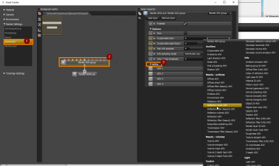

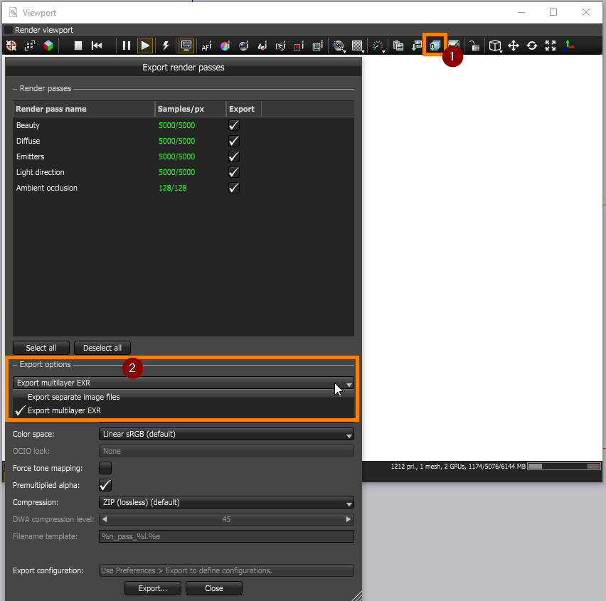

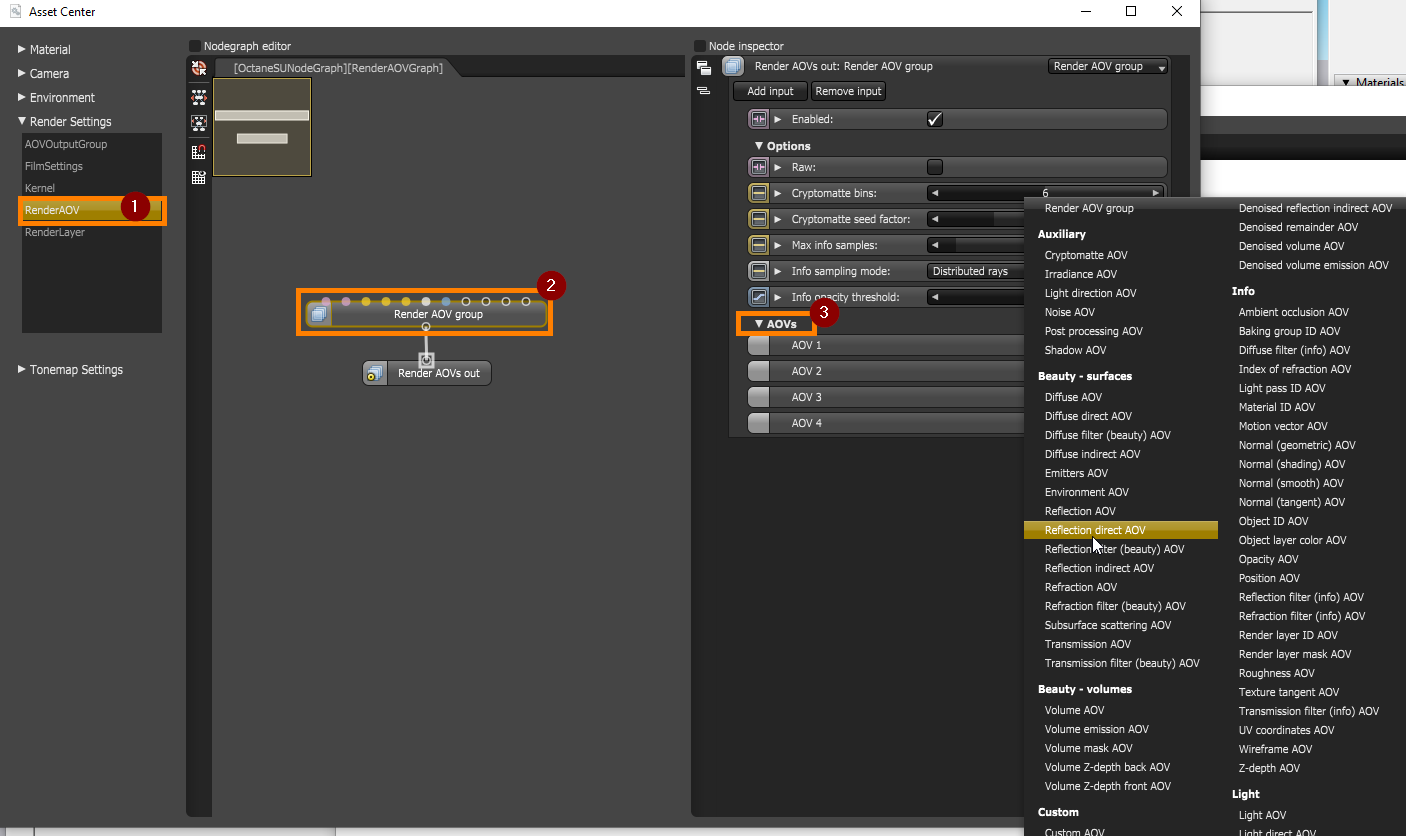

Hi Andyb431,
Thank you for the post and happy to help!!
Basically, we need the "show render passes dialog" to export multiple render passes.
The AOVOutputGroup can be used for compositing the rendered AOVs, color correct or light mixing workflow.
Please add a Render AOV Group node and connect with the Render AOVs out node like the image below to allow create multiple AOVs.
Then, saving the multiple image outputs please click the "Show a dialog to export the render passes"
We would reorganize the RenderSettings order in future releases and also automatically attach a Render AOV Group node with the out node.
Please let us know how it goes!

Hey BK,
Sorry for the delayed response, I had some issue with my SketchUp. All sorted now, and your response worked perfectly!!!
Thank you so much!
