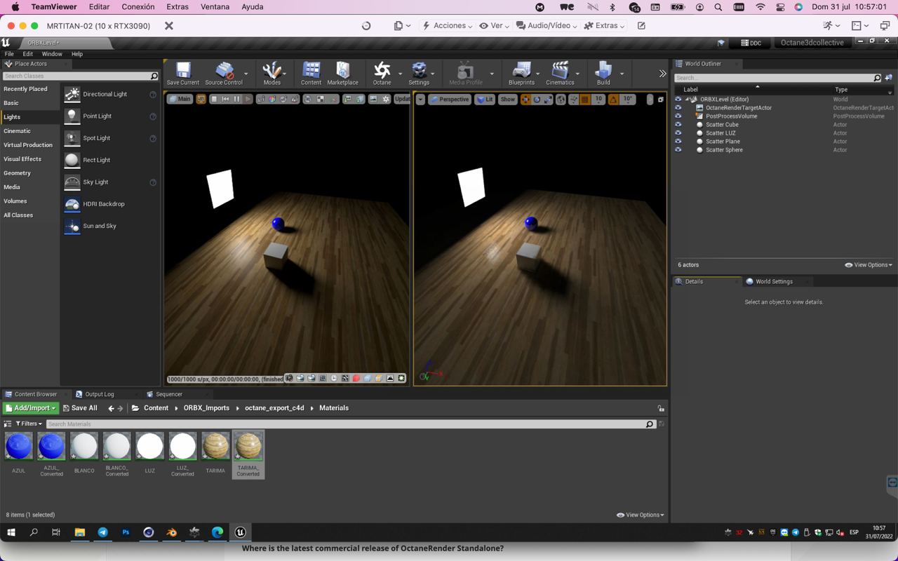

Hello Chris
Thank you for creating great software, very nice. I've tried ORBX Import and it works from C4D, in order to work minor manual adjustments in UE4 must to be done. I would like that the import plugin ask if it is Static, Stationery or Movable. Also some textures in UE4 must be linear, (Roughness, Specular...) would like also to prompt if this texture are Color, or Linear Color, when importing. If we use emissive lights with OctaneRender, we don't have any problem with UE4/5, just only need to activate on each Object Details/Light: Use emissive as static light, i wonder if we can automatize the activation of this checkbox on all emissive that are lights.
With 3DStudio Max or Blender, seems everything is based on alembic cache, don't know if we can convert into something more compatible with UE4/5, the scene appears rotated and don't seem to work.
Is there a way to import ORBX from Blender or 3DsMax like we do with C4D, i mean preserving all objects and scene?
Best Regards
Oscar

mrfactory wrote:Hello Chris
Would it be possible to give me a small example ORBX that shows this issue when imported to unreal?
I take it the linear color problem only occurs in the unreal renderer, and not in the octane viewport?
mrfactory wrote: If we use emissive lights with OctaneRender, we don't have any problem with UE4/5, just only need to activate on each Object Details/Light: Use emissive as static light, i wonder if we can automatize the activation of this checkbox on all emissive that are lights.
Ill see if i can add this.
As this is a component setting in unreal, whouldnt this be easier to do in the generated level where you know which object you selected? Instead of getting a list of prompts?
Or do you want to set them all via a default setting for every component in the scene?
This is up to the Blender and 3DsMax plugins. They would need to support the static/obj export feature.
Octane has 2 methods of exporting to ORBX.
- OBJ
- Alembic/FBX
When exporting to Alembic/FBX all geometry gets condensed into one underlying Alembic/FBX asset.
C4D Plugin supports both methods I believe, so does the Unreal plugin.
I dont know if 3DsMax/Blender plugins support the OBJ export version, you will have to check with them.

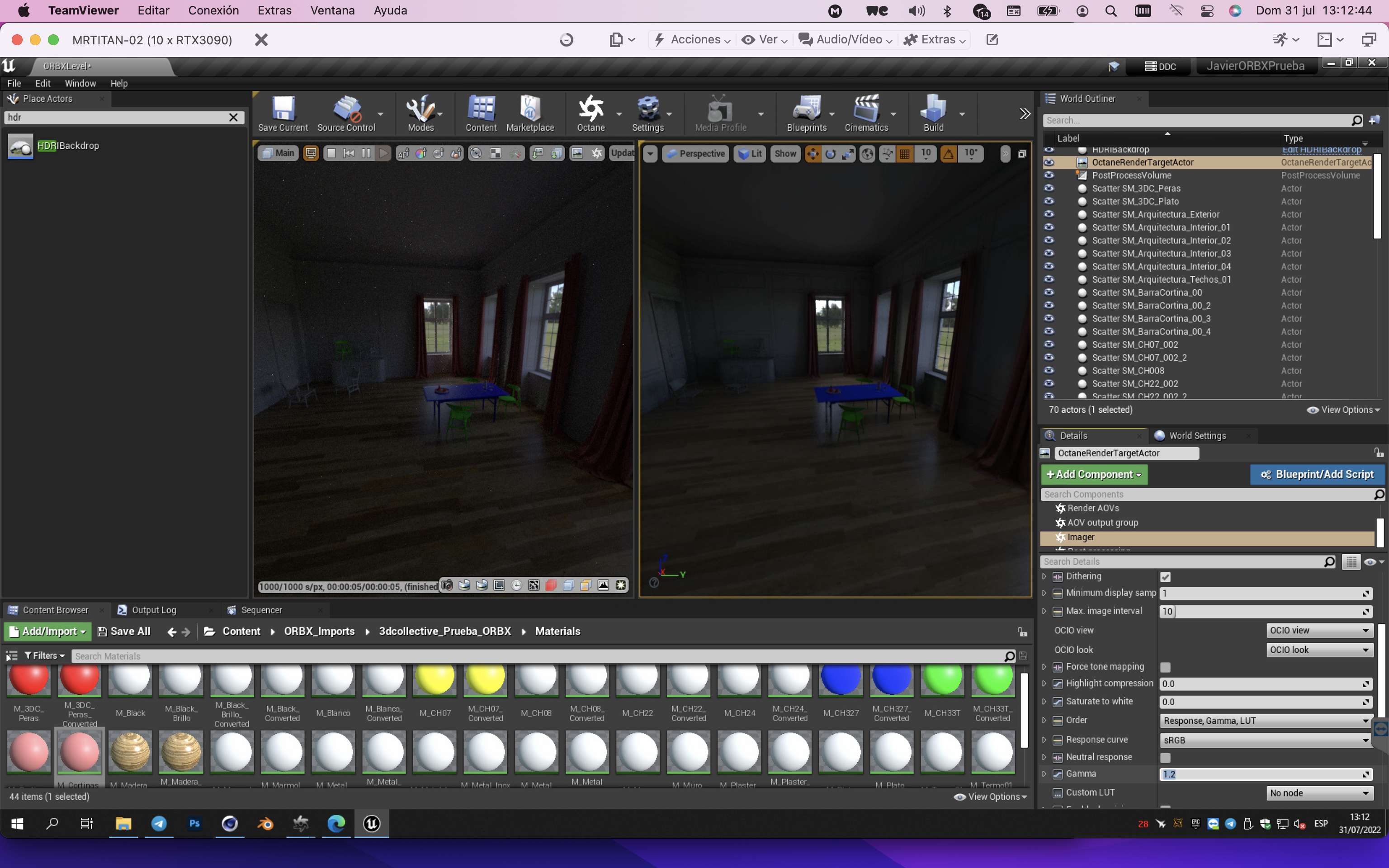

mrfactory
Posts: 43
Joined: Sat Aug 06, 2016 10:48 am
Thanks so much Chris.
To create materials we usually use Poliigon Textures, those ones need that all Grayscale Textures (Roughness, Specular, ...) to be Gamma=1.0 or uncheck sRGB.
https://www.youtube.com/watch?v=o0648Sfom8M
https://www.youtube.com/watch?v=ROYyVUxEX14
https://www.youtube.com/watch?v=1GkS9-94k80
Find attached on this wetransfer all the ORBX, UE4 project, c4D projects, textures and HDR for testing https://we.tl/t-SeBkiTKfrl
I would say the best is to set defaults for all import settings.
We will continue testing the ORBX-UE4 workflow, it is very important for us.
