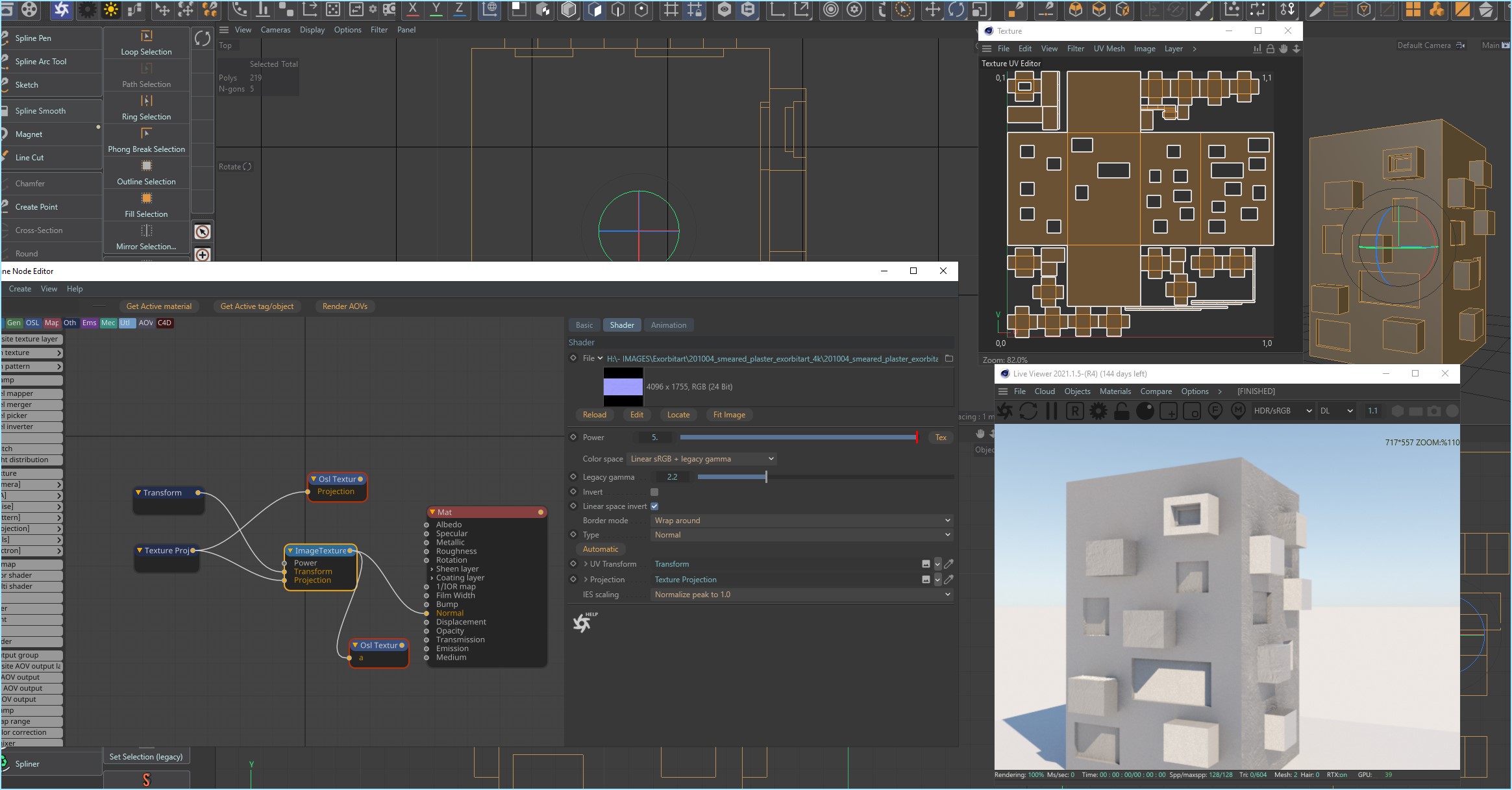

There is issue with some linearized normal maps while using UV map generated by Automated UV Packing because UV polygons islands are randomly rotated. The problem is only with normal maps that are linearized :
Problem is gone when these maps are converted to sRGB 2.2 gamma.

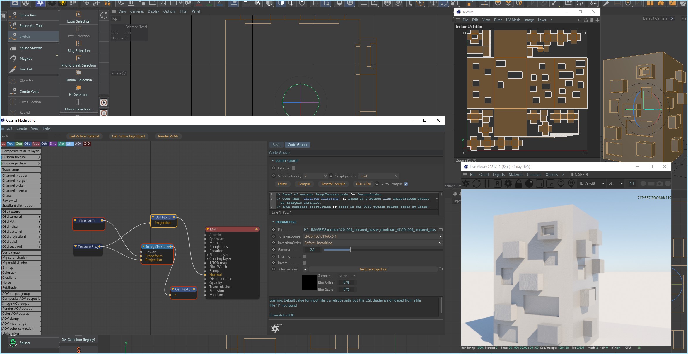

Unfortunately Octane doesn't support gamma changes for normal maps. The only way is to use OSL script :
So please add support for changing Normal maps gamma or Color Space as it is for regular texture images.

Problem with OSL version is that OSL doesn't have Transform node connection and Power of the texture but it generate correct shading.

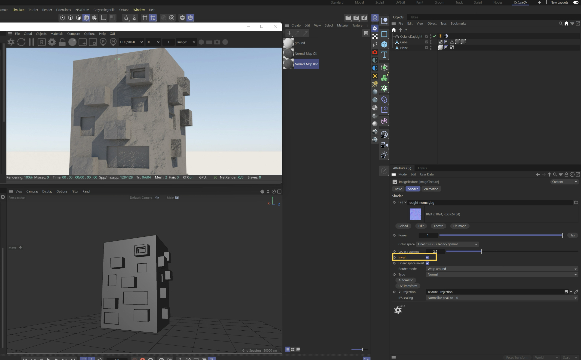

if you enable the Invert option it sems pretty similar.
On the left Normal texture, on the right OSL version:

bepeg4d wrote:Hi,
ciao,
Beppe
But after that bump effect is inverted too this can interfere with bump channel texture.
