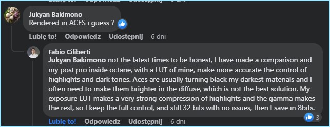

I'm not only who see ACES problems :
https://www.facebook.com/groups/OctaneR ... 5034964229
ACES produce low-dark areas very dark in Octane LV. Working with ACES cause to make post processing. If you want proper view in LV you must rewrite all materials.

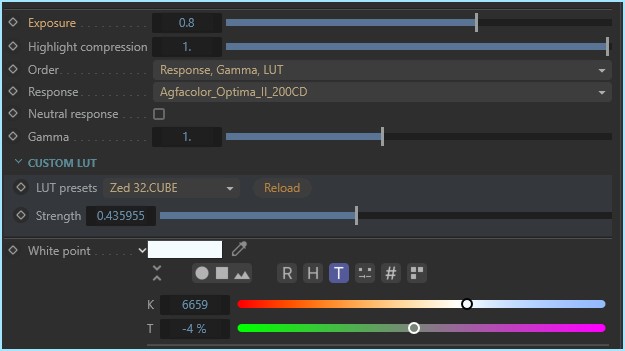

Orginal :
ACES :
Camera Responses, Lut's, Exposure, Gamma, White Point magic all inside Octane :
ACES :
Magic in Octane :
Response_Lut.zip
(642.31 KiB) Downloaded 226 times

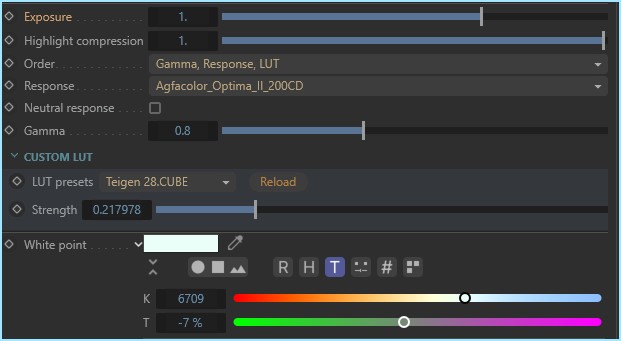

Aces simulation with Camera Response + Lut :
Agfacolor_Optima_II_200CD_Zed_to_Aces.zip
(277.33 KiB) Downloaded 163 times
Left -> Camera Imager, Right -> ACES
Near 98% the same blue and green tint using Teigen28 cube but different settings :
Architectural Visualizations http://www.archviz-4d.studio
