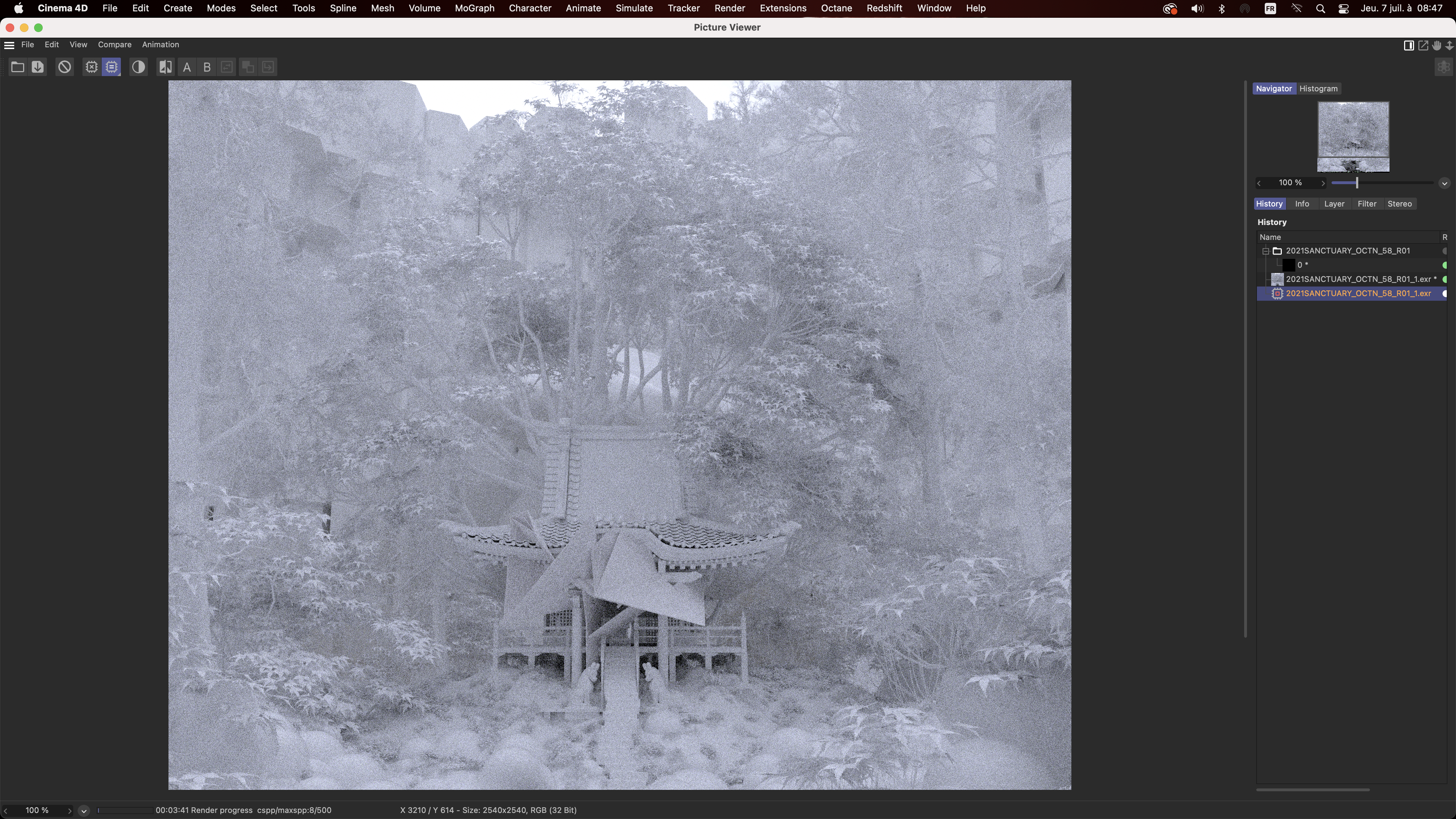

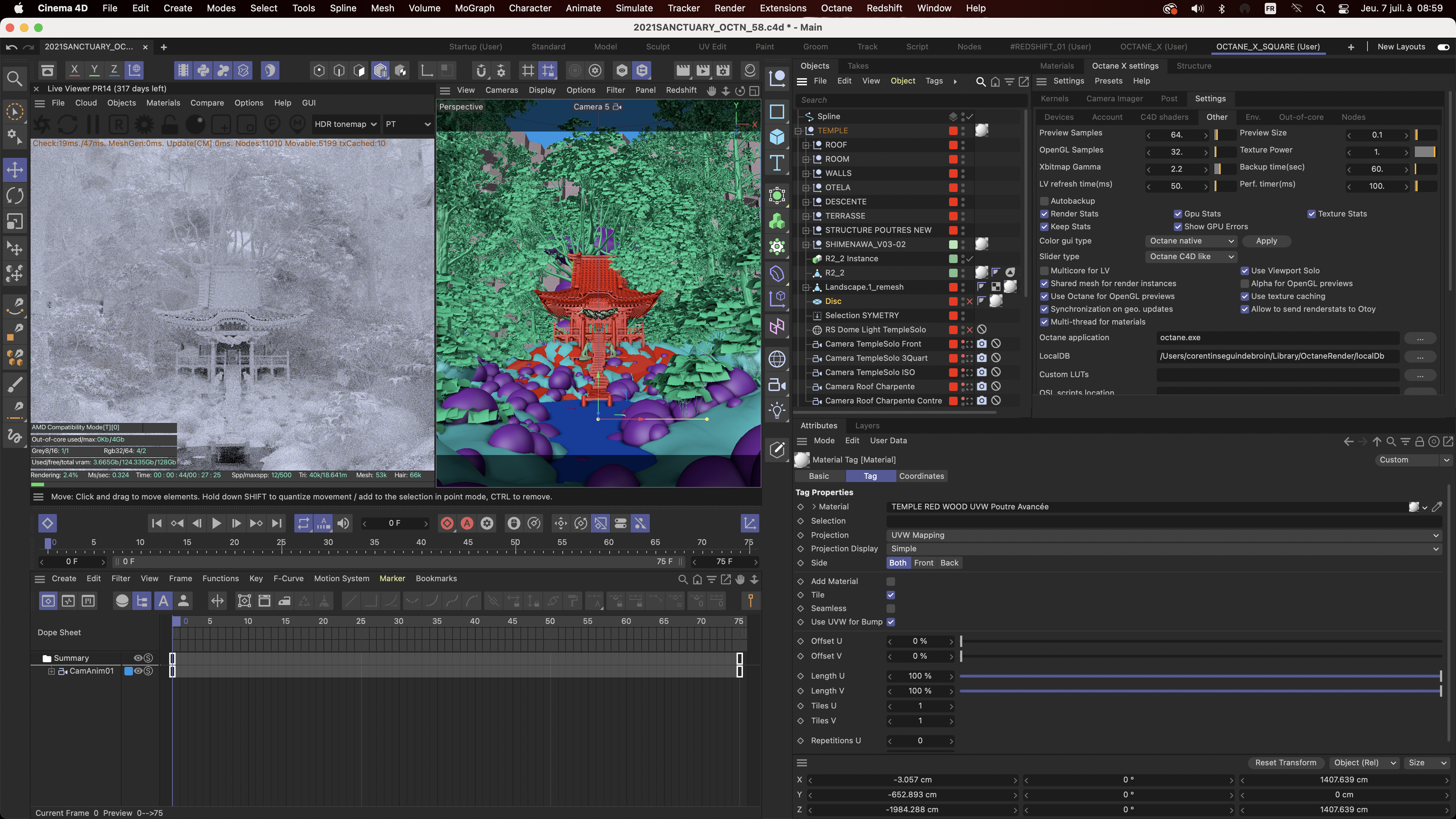

When I render in Live Viewer scene renders like it should. When I render in picture viewer there geometry doesn't seem to load correctly.
C4d r25 (roseta), Octane X PR14, OSX Monterey, M1 ultra 128 Ram

OK, I debugged the scene :
Render Instance doesn't work. Just switching them to simple instances and hidding them to viewport for fluidity work.
And Octane doesn't read "reeper" (V3.2) plugin, so I had to bake it.
