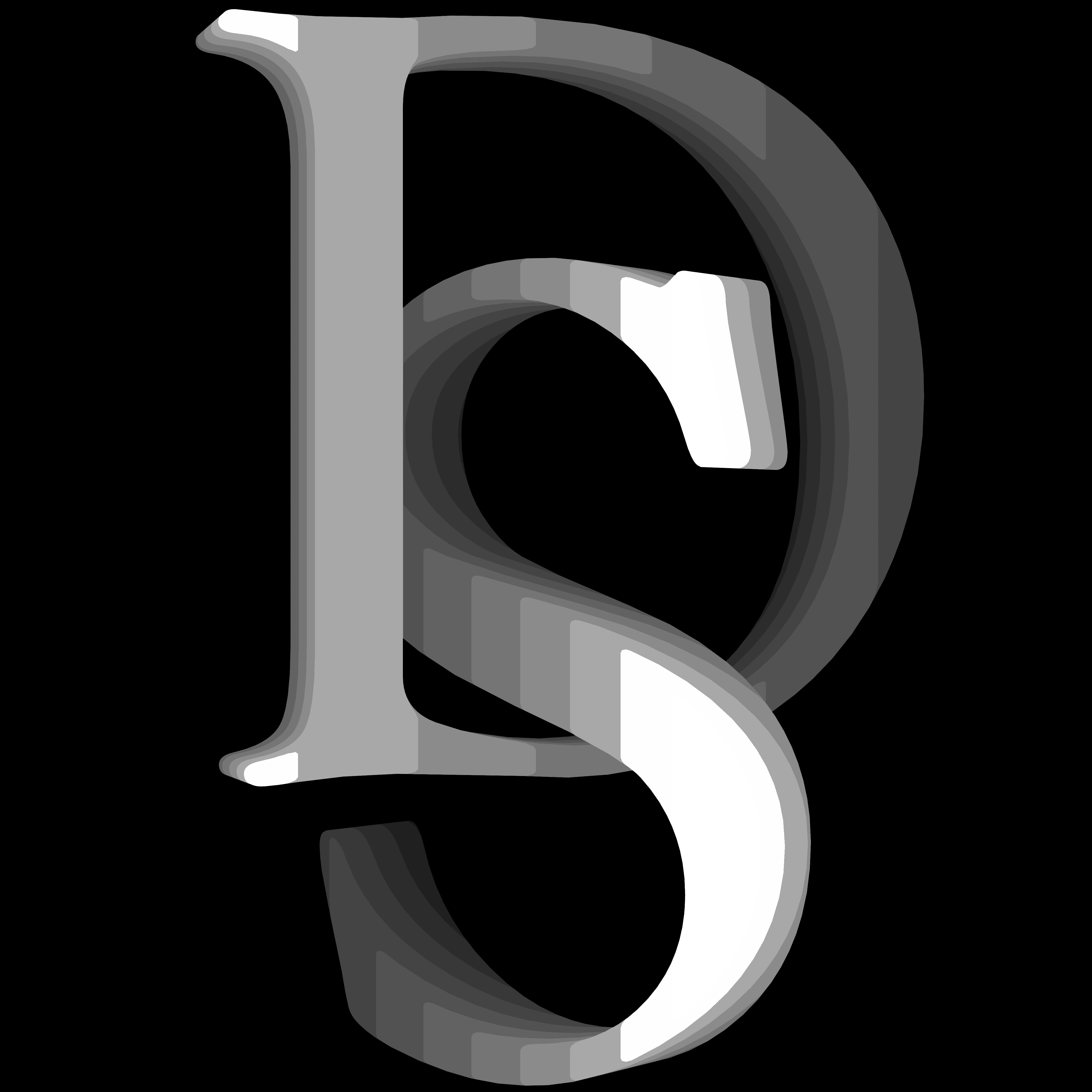

Is it possible to get better results with the z depth pass on small scale items? The 'enviroment depth' in the zdepth render AOV doesn't seem to do anything in the live viewer. Basically I'm trying to render out different passes to comp and create an image to be used with a CNC Router.
My workaround will probably be using a diffuse gradient texture in word space with white towards the camera and black far from the camera IF I cannot dial in the Zdepth

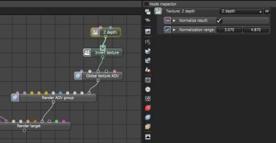

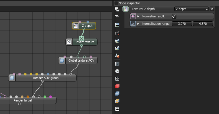

To get more customized AOV you can use a Global texture AOV with a utility texture or a custom shader.
In this case you could use the Z depth texture, it has a normalization range to map start and end values to [0..1] range. This will put black at the start (near) and white at the end (far) point, so you could plug that into an Invert texture node if you would rather have white near, then plug the output into a Global texture AOV.
To interactively find the right values you could temporarily use the auto-focus picker and check how it changed the focal depth, then put it back to its original value.
This will also change when you move the camera (like a Z depth with a min depth would) so if you really want something in world space maybe try playing with the Relative distance node into a global texture.
