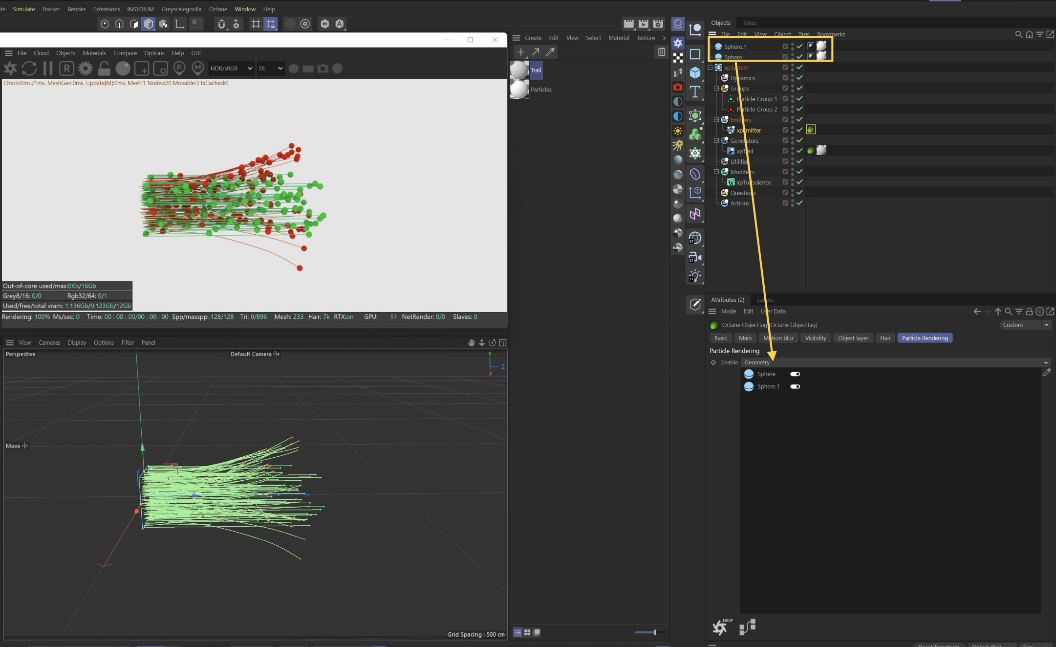

I'm trying to use groups to separate particles, the first particle is rendered but the second one is not.
The first group is rendered, but the second is not.
The second group is just turbulence.
Only the Trail seems to work well for both.
Project file

Posts: 10651
the trick is to create 2x objects, one per group, and assign them to the Geometry list in the Particles tab of the Octane Object tag assigned to the Emitter:
Then use the Instance Color node for coloring the particles, and the Attribute Texture node for coloring the trails.
Here is the modified scene file:
sample_b.zip
(101.73 KiB) Downloaded 174 times

I was able to recreate it.
Thank you for your help!
