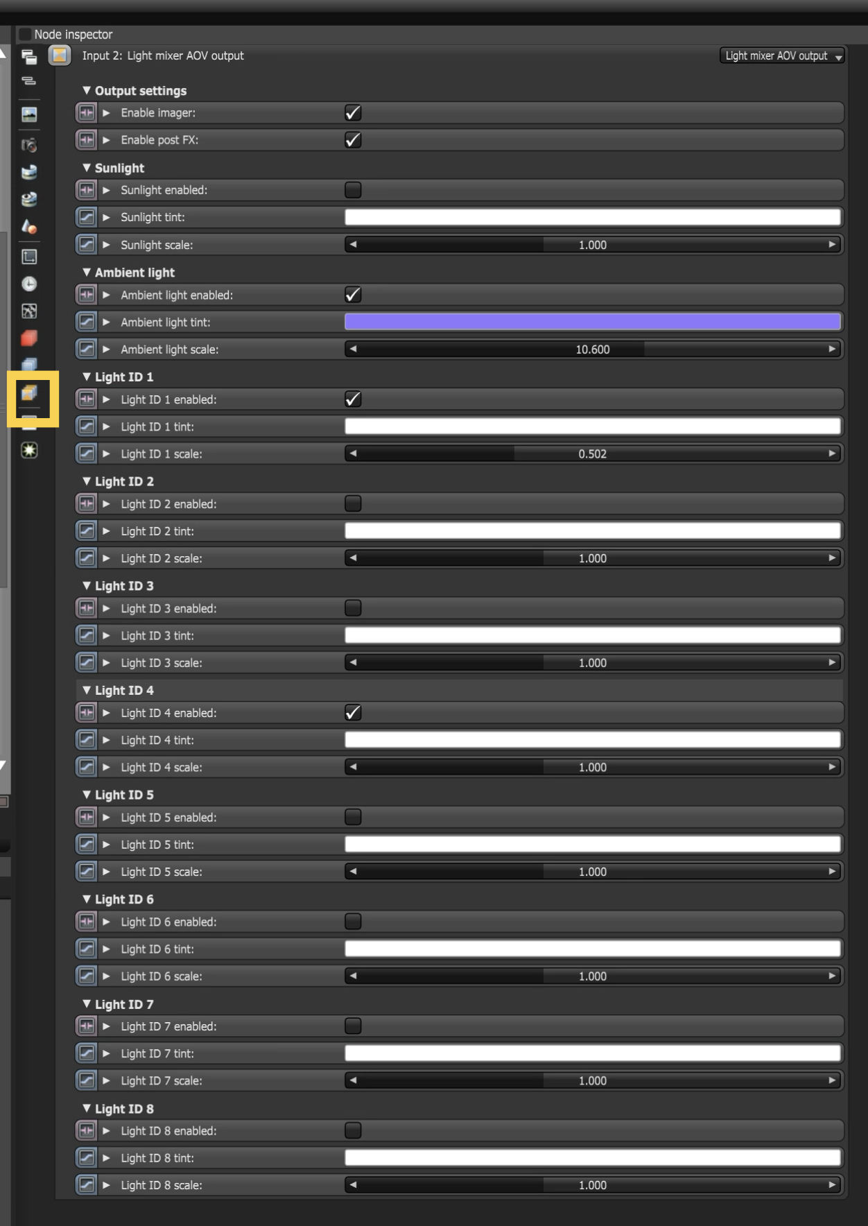

Hi AN,
beauty passes are incompatible with light passes, so you should need to render each individual light ID with beauty passes, then compose them back together in post.
On the other side, Light passes can be split in Direct Light and Indirect light passes, per Light ID.
Have you tried the new Light Mixer AOV output node? ciao,
Beppe

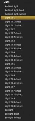

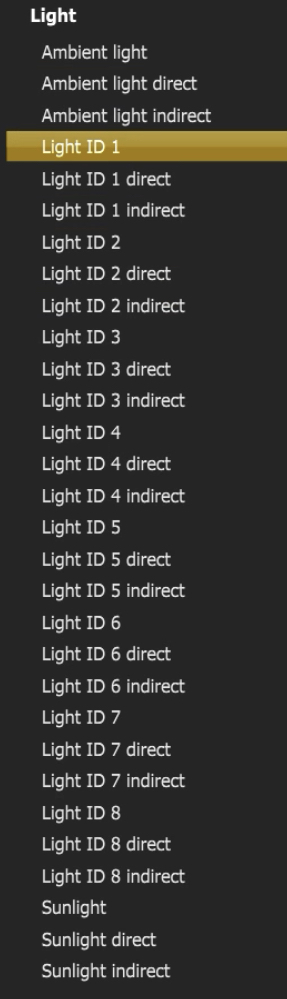

If you enable all the Light AOVs/passe, without tweaking them, you obtain the exact same render as the Main Beauty pass
What I mean is that you cannot split each Light pass in Diffuse, Reflection, Refraction, ecc., but you can split each Light ID in direct or indirect lighting. ciao,
Beppe

Right so I need to render 3x the number of passes? Hmm that's a bit of a problem.
I'll have 24 passes just for lights, to be able to control in post? Seems like a missing feature?
Agree with not wanting to split each light into diff, refr, relf, etc. Just each light's "bty" is what I am after but the light ID is not the full light "bty" it seems, that's only obtained from the ID + direct + indirect.
Would you guys consider adding a "light bty" in future, so that we could export 1 pass that is the combination of ID+direct+indirect? As currently 3x passes for each, is a but much to deal with.
Thanks for clarifying.
