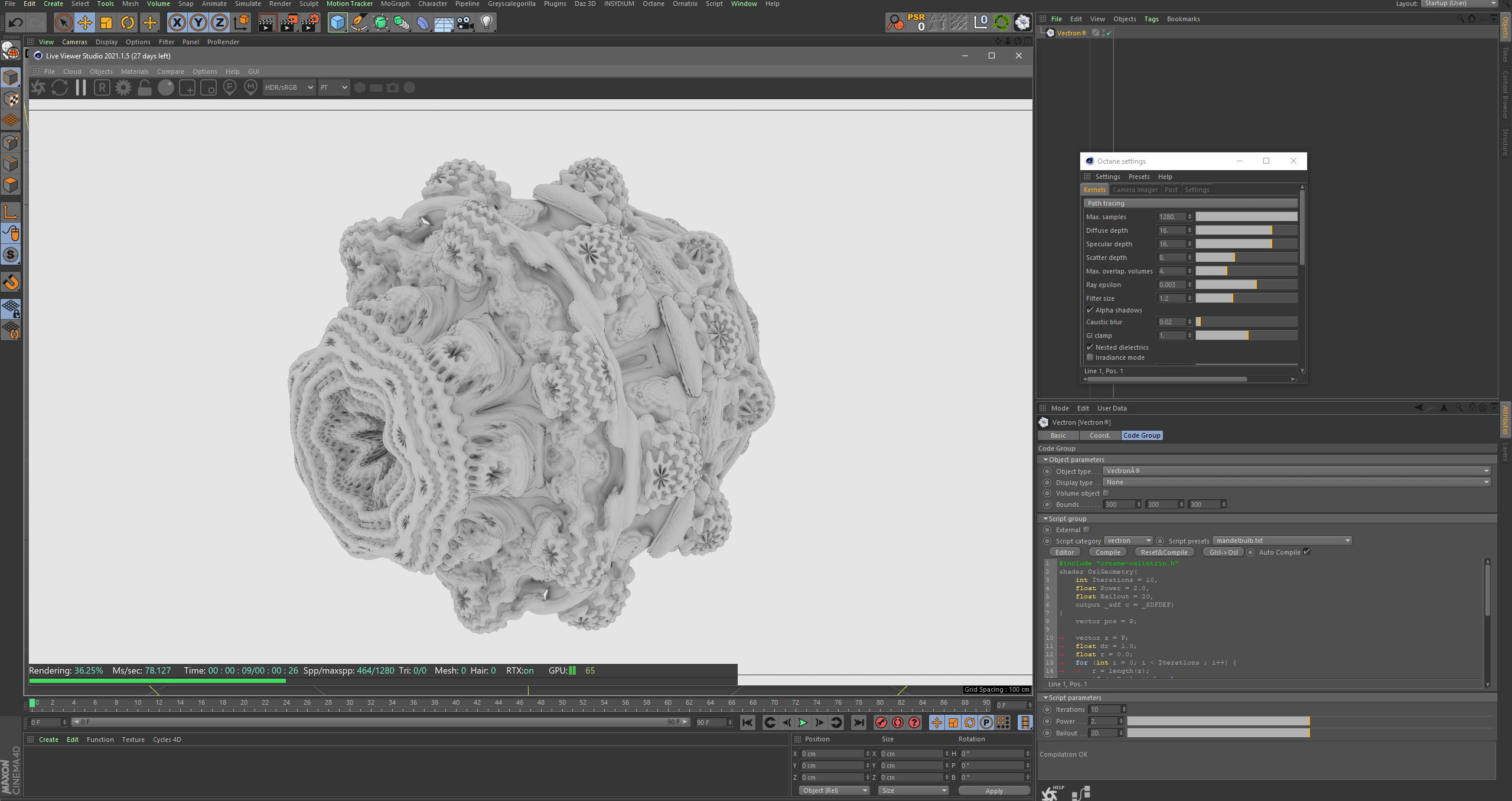

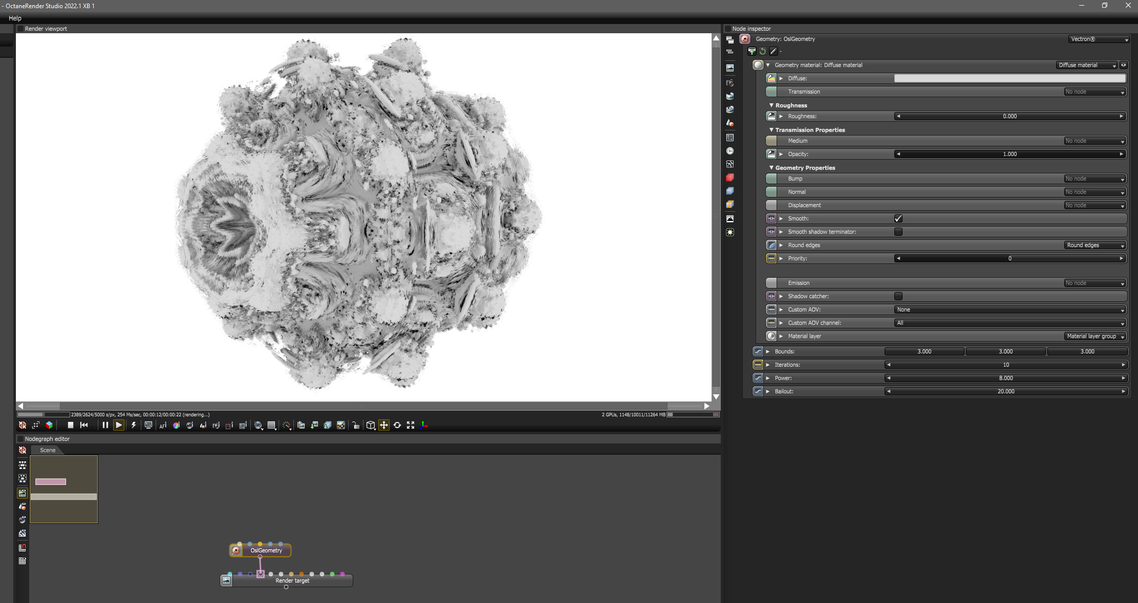

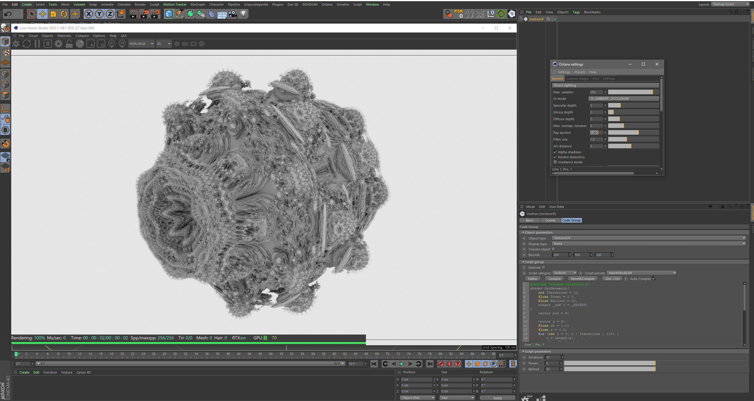

It looks like even example mandelbulb is not rendering correctly. To render fractals the output dist should be arbitrary I think or it will end up in a badly rendered object, or in worst cases an empty render.
Here's a screenshot from Octane standalone 2022 example Mandelbulb fractal and the same setup in 2021 C4D and 2022 C4D with exactly the same settings.
Hope this will help fixing the bug, since we can't do anything from user side.

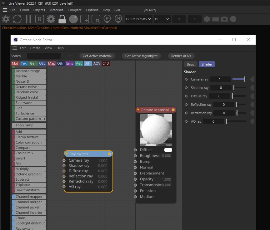

One question: when are we having an updated "Ray Switch" node?
XB1 standalone already presents "Add an input for photon rays to the ray switch node, and support raytype("photon") in OSL". I can't seem to find photon on C4D plugin side.

Kalua wrote:The plugin is working nice so far.
Regards,
My answer: I'm not aware of it. So I'll add that because you've reported. Thanks!

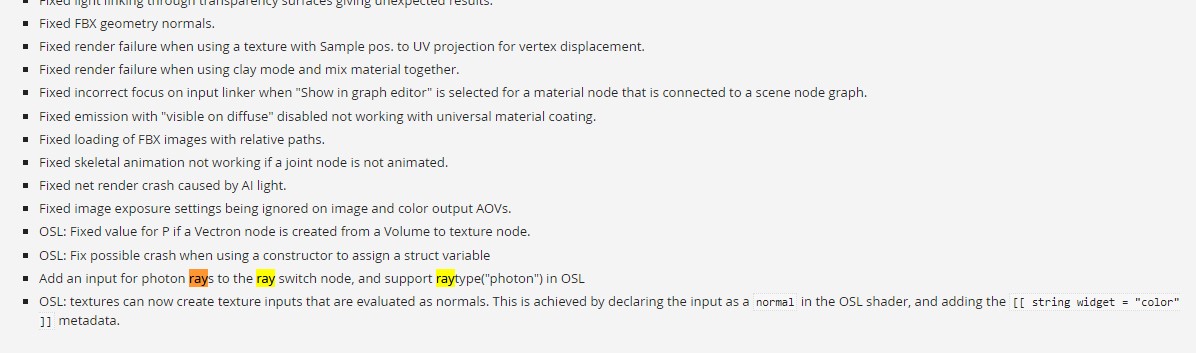

But it is on the XB1 features list: viewtopic.php?f=33&t=79602
