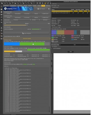

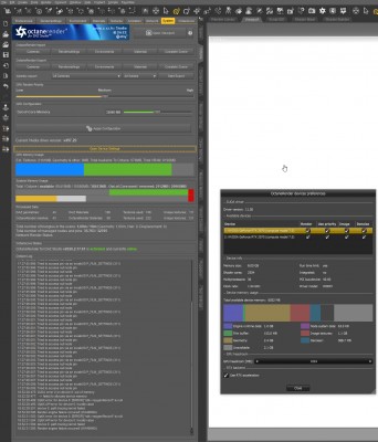

I've made a screenshot of the system-tab after rendering a single image in the normal viewport and I made a screenshot of the system-tab after the animation crashed. It looks like octane tries to put geometry and textures in the memory again which leads to the crash, even though there should be more than enough ooc memory.
After rendering a single image:
After one frame of animation rendering and memory crash:
