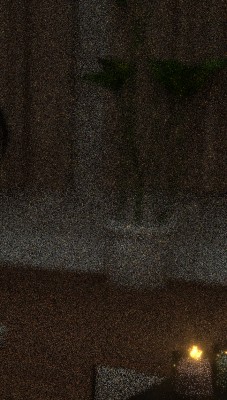

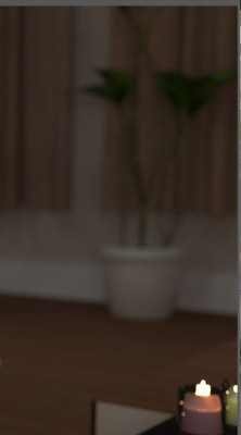

I have tried again and made some screenshots for you to look at 1 in viewport with snippet tool and one of the saved image in the animation
Finished-saved.jpg is what octane saved to disk before moving to next frame Viewport-snippet .jpg is from viewport right before octane saved and moved on to next frame

Thanks for that. It definitely looks like it is saving the image from earlier in the rendering process.
Do you have instances in your scene? That is, do you get the warning dialog saying "Mesh couldn't be combined because the scene contains instances"?
It'd be really helpful if you could confirm that this issue doesn't exist in builds 65 or 66.
