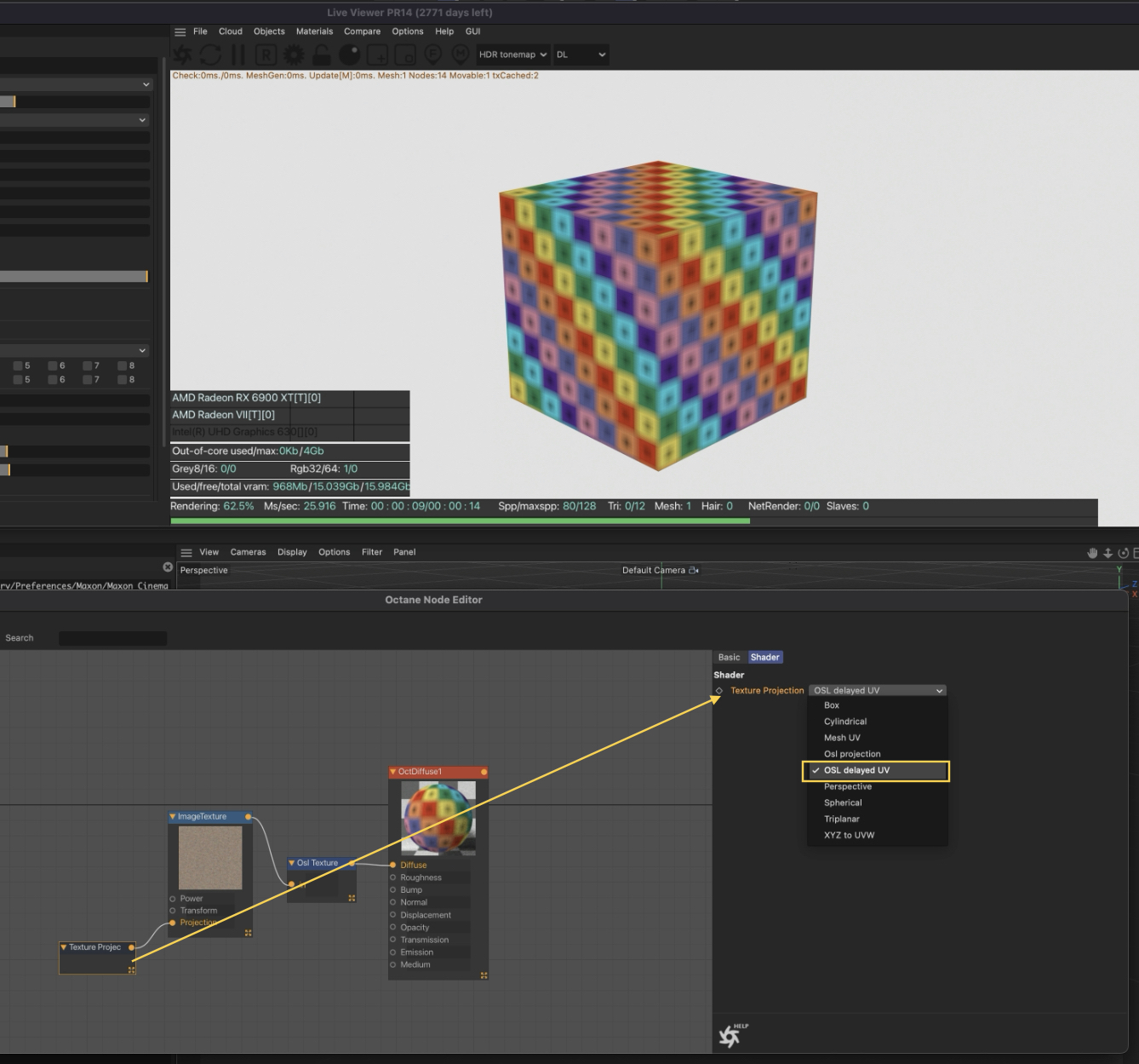

I need to blur a bump map texture with node but I could not get a blurred result from the GaussianBlur.osl node.
Can anyone help me with What I'm doing wrong here?

to make it works, you need to set the Projection of the input texture to OSL delayed UV:
ciao,

Thank you @bepeg4d
