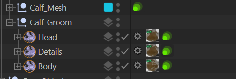

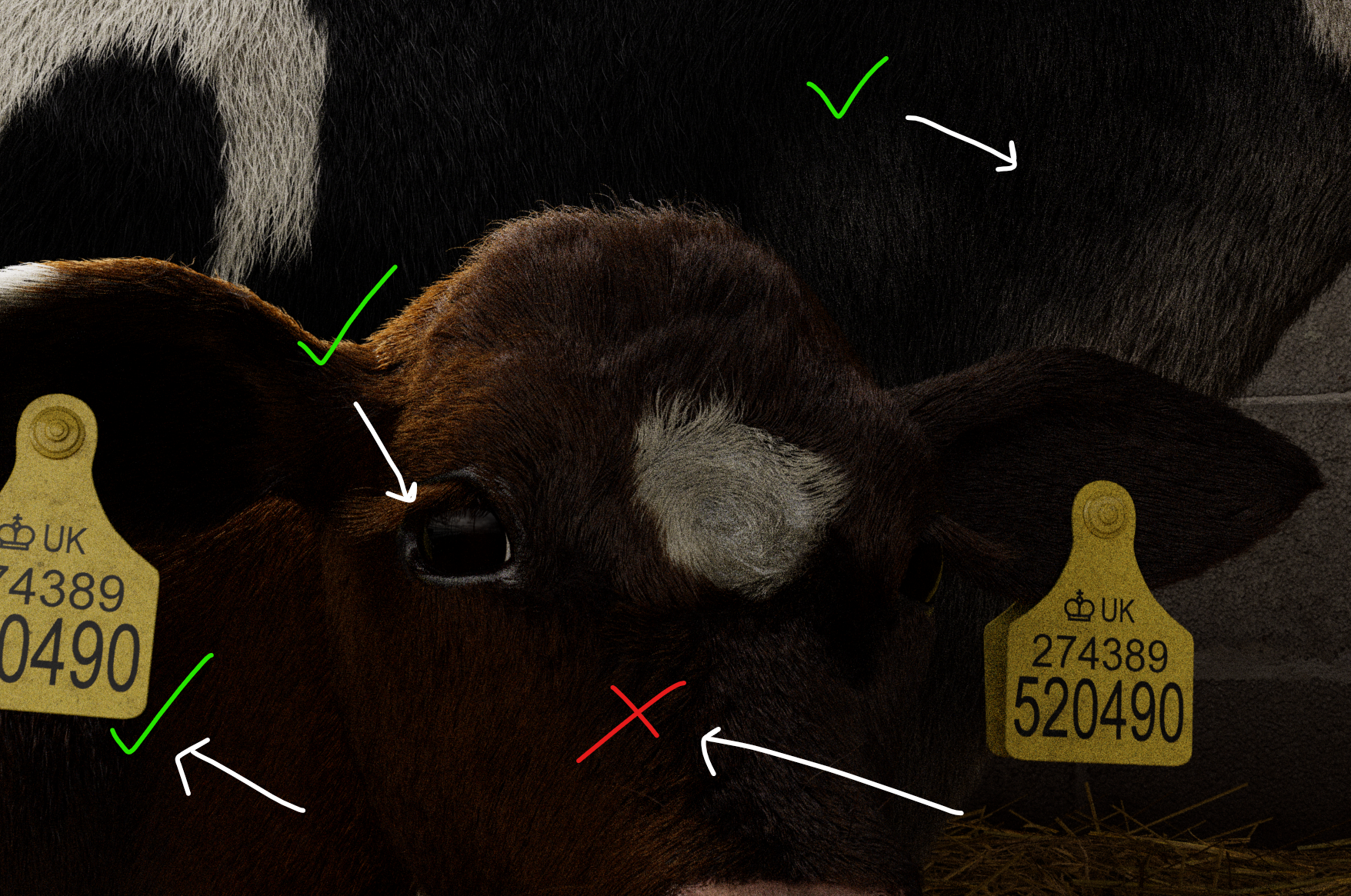

I have a super strange bug that seems to only affect 1 of 6 Ornatrix hair objects. I have an octane tag on each of the objects set to transform/vertex. The scene crashes on one of the early frames each time. When I remove the octane tag from one of these 6 hair objects (one of the character's heads) the scene manages to render.
Please please can someone take a look at the scene for me? Ornatrix support won't look into this for me as they are blaming Octane for these issues as it's motion blur related.
I would be so grateful to have some help on this. It definitely seems like a bug as motion blur works great on some of the objects.
