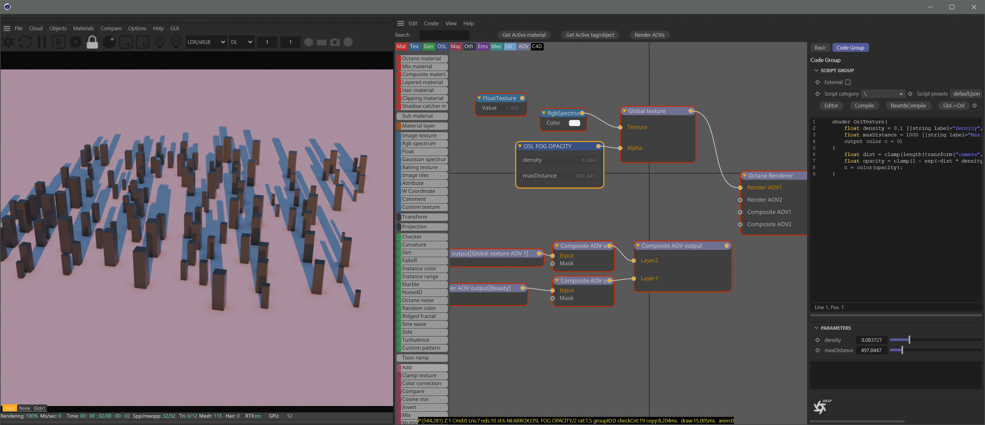

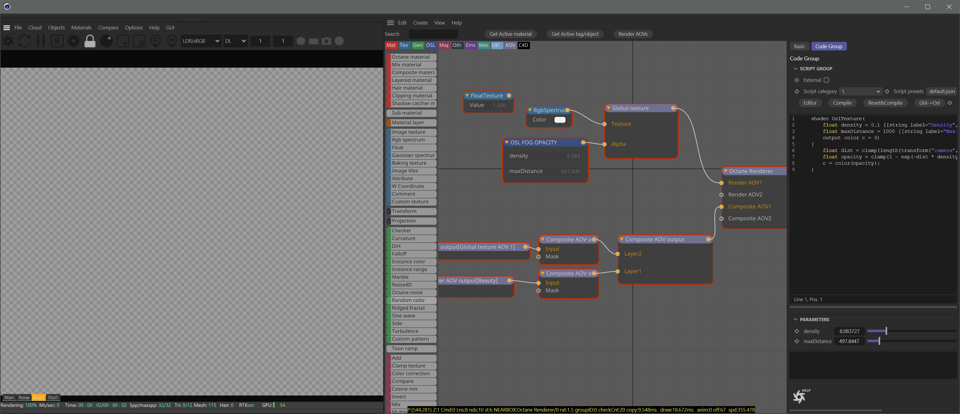

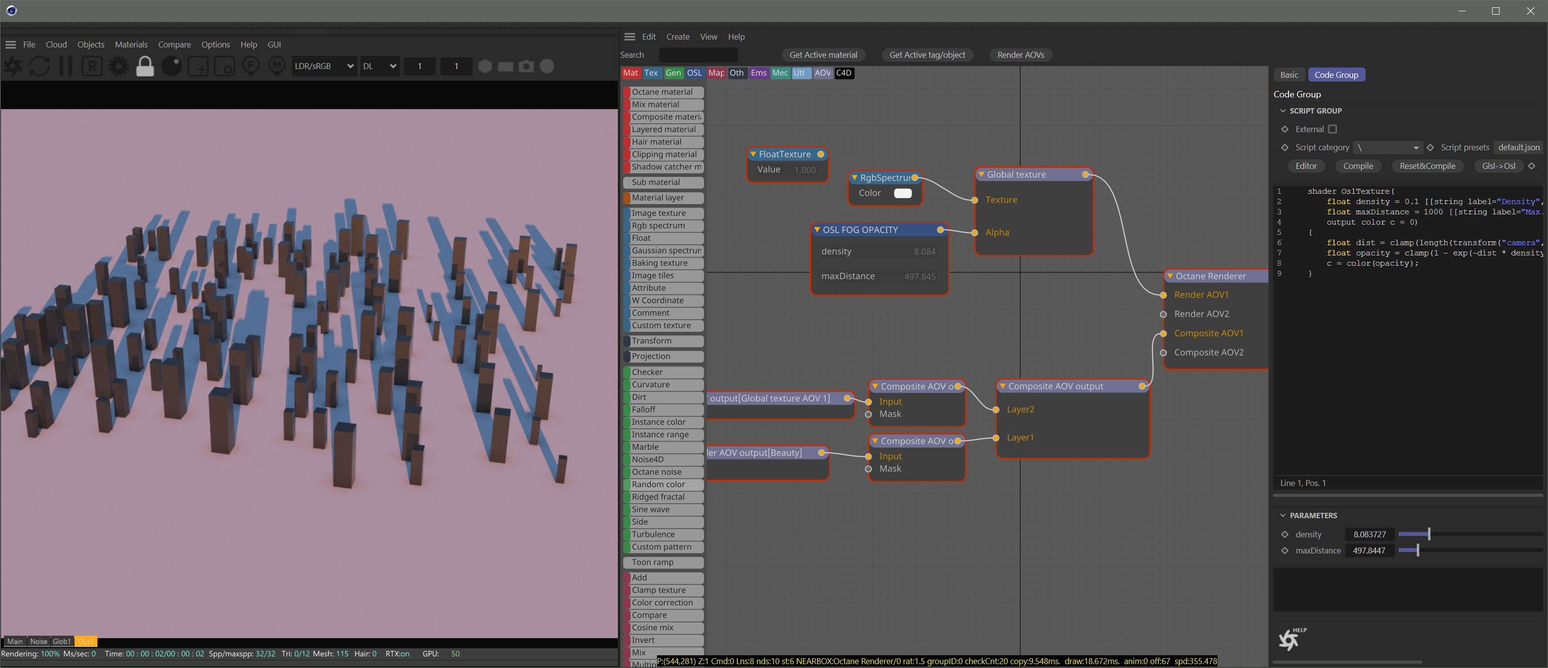

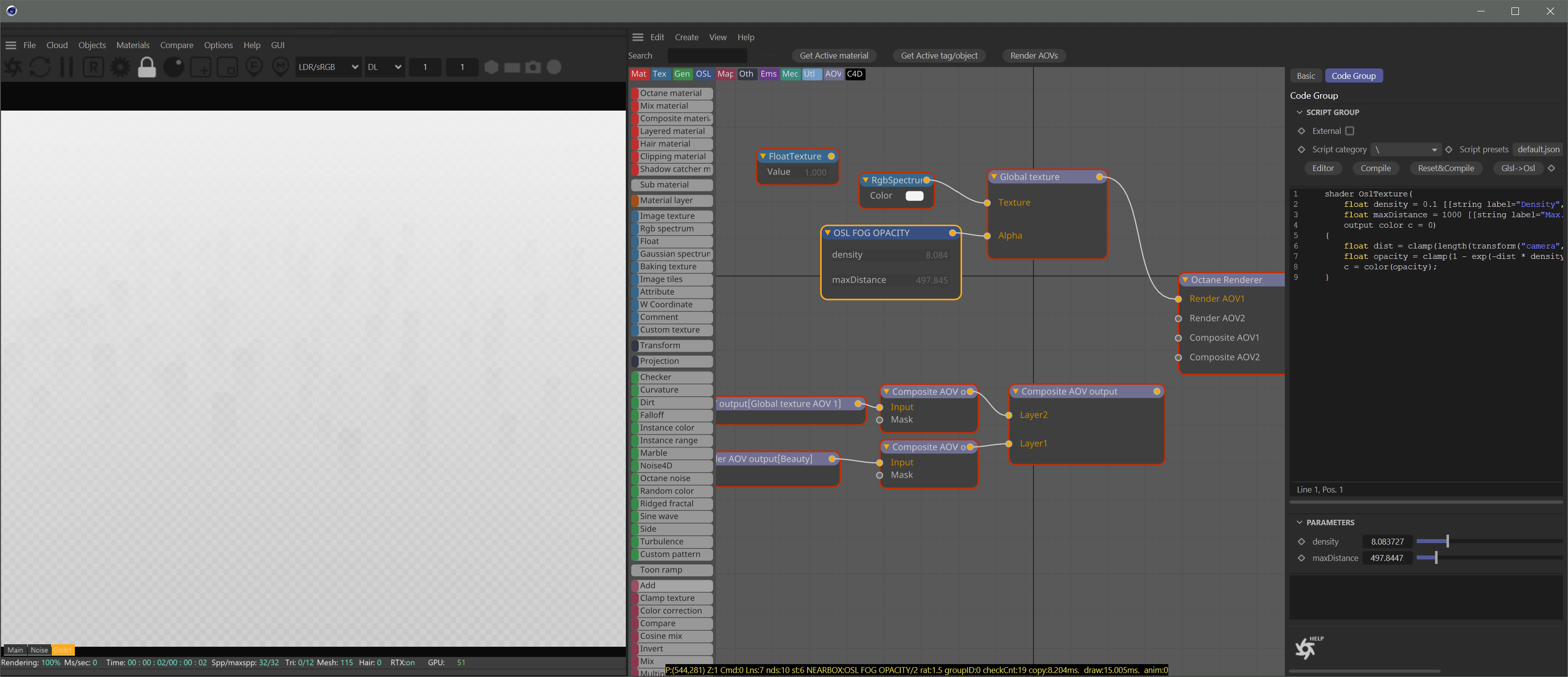

Thank you for this! any advice on getting it working? I can get the Global Tex AOV to show up correctly if the Composite AOV is disconnected, but as soon as I connect the Composite AOV, my Global Tex AOV disappears and I can't get the compositing to work at all. What blending modes do I need for the Composite AOV Output layers?
